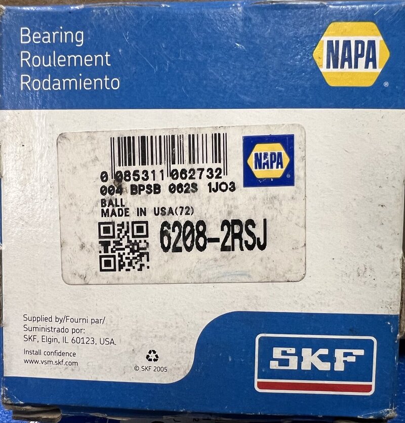

Can you post the part number of the US made bearing?
Thanks
SKF Bearings are made in USA.
Their direct number is: 6208-2RSJ
This number cross references from the main number used in the industry as: 208FF
(MRC is also made in USA with manufacturing plants in CT, NY & PA…. SKF owns MRC, so you may be able to get those cheaper. Those will be a 208SFF. (The “S” meaning “sealed”)
That industry part number: 208FF is also used by MRC, National, Timken, just to name a few.
You may see variations like: 208-FF & 208SFF
I actually bought the SKF from my local NAPA store due to my HD dealer said the OEM ones (made in Korea I think) were on back order with an ETA of the end of this month. (I didn’t want to wait so I paid more for the SKF and got them right the next day).
