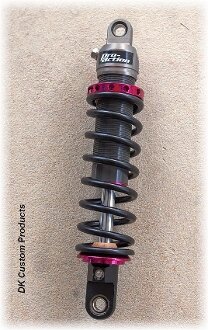

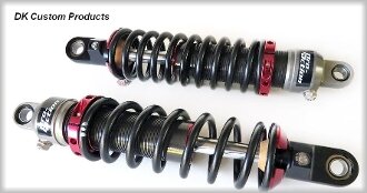

Today I changed my mind and changed to the Pro Action Street Series USA made rear shocks from DK Custom instead of the Bitubo Italy made rear shocks (DK claims no noticeable difference in ride) for our 2017 Tri Glide. I just thought I would support a USA company instead ThumbUp. Also I like the looks of the Pro Actions shocks better not that that really matters.. I also liked the limited lifetime guarantee and if warranty was needed it would be much easer to deal with a USA based company.
Have heard great things about both sets/brands of rear shocks that DK Custom offers for the Tri Glide. I hope they will be here next week :cool:.

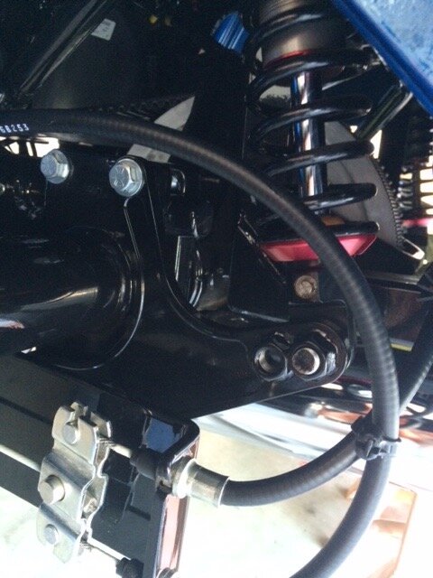

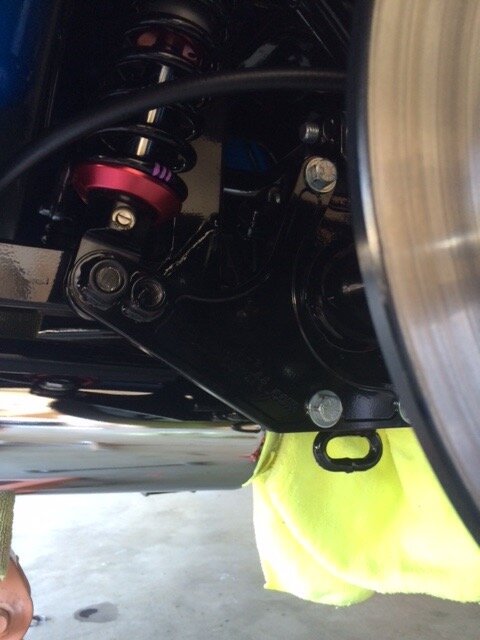

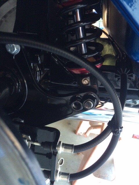

Update on shocks for ya
Pat,
The Pro Action shocks are superb. They worked great with stock Harley shock brackets but worked way better with rear lift brackets installed.
The 1" lift brackets I installed instead of the 1.25" lift brackets normally used on trikes gave me 1 1/8" lift at the muffler tips verses the 1 3/8" given at the muffler tips by 1 25" lift brackets.

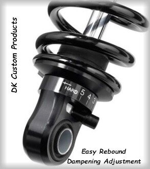

They Also gave me the more rear angle shock mounting position. Pro Action recommends the more rear angle for better shock function.( Like the popular comfort lift that's on the market)
These 1" lift brackets were made specifically for the 2017 model trikes taking into consideration the header and swing arm clearance issues known on 2017 models. I had this issue with our 2017 trike.
Now the Ride is just awsome and the trike floats over bumps. Of course you got to get the shocks dialed in with the spring load and the clicker adjustment. After that the shocks are bomb..
The trike now sits nice and level and steers great and as said the ride is awsome with the Pro Action shocks installed.
Ride Safe,
Bill G
