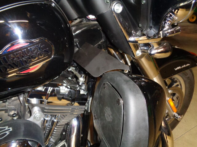

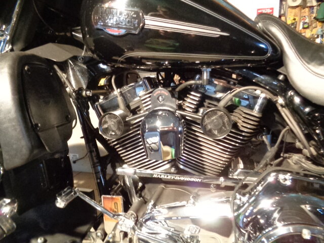

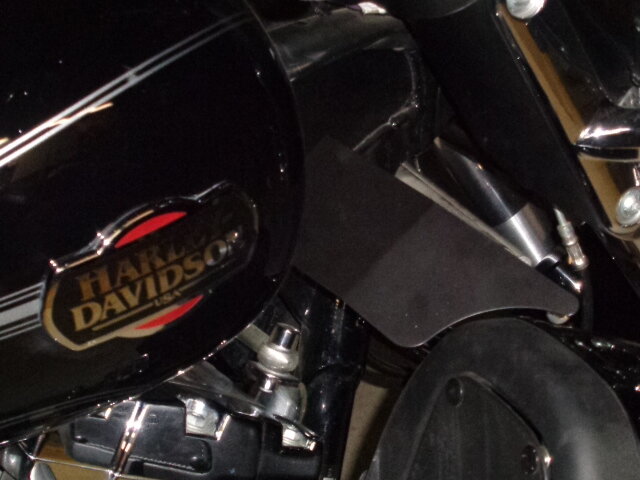

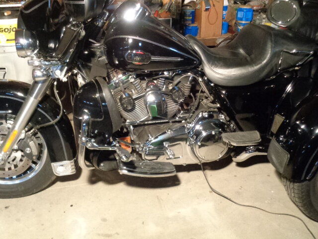

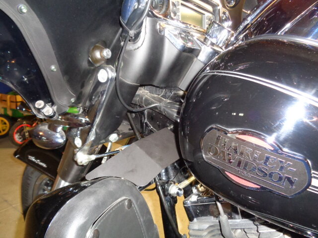

Now I lifted my tank 2" and put the first generation of air deflectors on, I tweaked mine because of the dragon fly adjustable wings on Old Shiney. It seems they really work for me between the air deflectors and tank lift.If I still smoked I believe I would be able to, going down the road. I'm sure the LRS flat top windshield also plays a part of air management, but still the air deflectors also push more air on the Motor and that is a good thing. Good luck in whatever you decide.:good: travel safely Fred

I put the DK deflector on years ago to kill the buffeting coming over the tank in the cold weather. I take the plexiglass part off in the summer and leave the metal mounting bracket on. I would give the effectiveness a A+. My trike is a 2010.
Thanks Fearless.....Do you feel the Tank lift helped the buffeting? I've thought about the tank lift, both front and back, but not sure how it effects the gas pickup......I think if I did the lift, both would be best, and I assume it's just a matter of bolt removal etc. jc

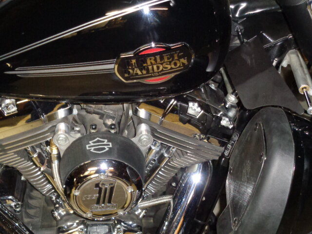

I get no bugs on my fuel tank if that tells you anything all go on deflectors and lowers the tank lift also helps increase air flow on motor do both lift and air deflectors. Run your tank low on fuel easier to maneuver (lighter less gas) simple remove seat and loosen back anchor bolts remove front tank bolts really loosen rear ones get the deluxe lift with spacers for rear. don't take them all out at one time one end or the other hard to control fuel tank by yourself. I used pine wood wedge to hold up tank, I was working by myself. Really easy little tight quarters on front but doable with common tools. Be safe Fred

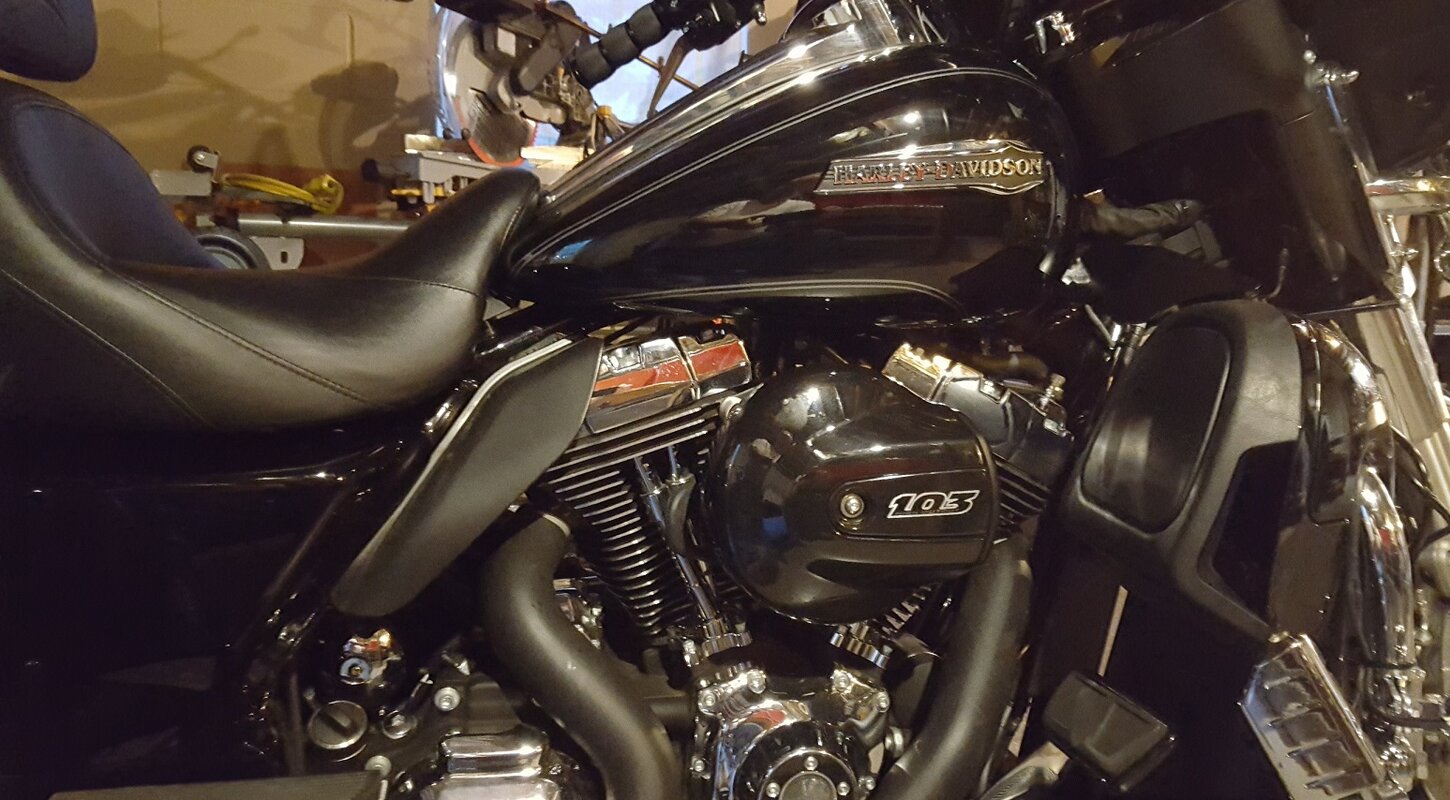

I just put these and a 1.5 inch front and .5 inch rear tank lift on my Freewheeler this evening and I think I read where you have to have a tank lift for these to fit.
You will love the difference in the air over the tank. DK Customs could answer the question about the lift and Air deflectors I lifted mine two years before the air deflectors were available. :drinks:ride safe Fred
I installed the deflectors and noticed a big difference/reduction in buffeting. I too have the deluxe tank lift, but it was installed about two years ago. I believe that even without the lift you will notice decreased buffeting. I think the tank lift with the deflectors wings will give better results and as stated help with cooling.

Wish I had seen these pictures before I installed my deflectors, then I would not have mounted them on the wrong side :) and had to take them off and swap sides :)

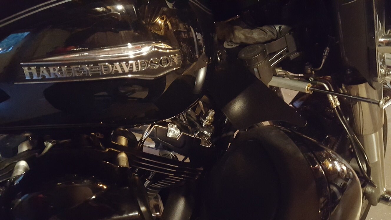

JC I'm not sure which bars you changed to but my 2+2 wide sweepers I have no clearance problems. I chose them in part for the convex shape everything works just fine. 2" lift no problem and I could bring them back a little if needed. I really wanted bagger bars or 14" apes but the way they were made I didn't think they would work being either concave or straight coming off riser. :Shrug: ride safely Fred
