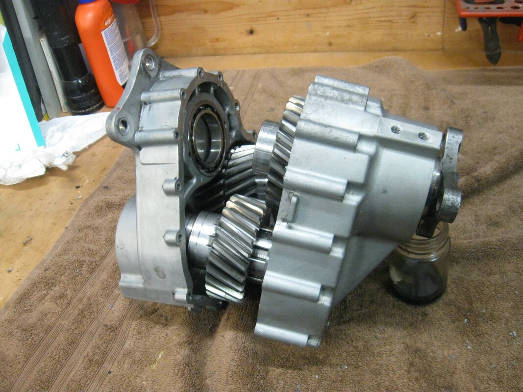

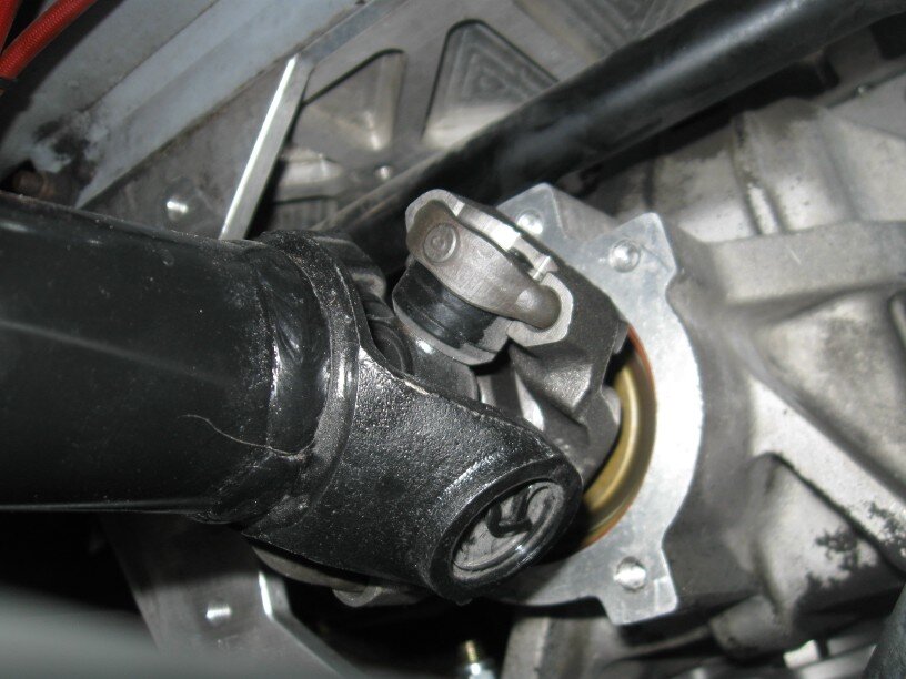

Below are pics (providing they download)of my new CSC Retro kit installed on my 02 Wing. You can see the 3 of 4 remaining bolt holes that are no longer holding the gearbox in place. About 31 lbs. shed and soooo much better. Slight improvement in mpg as well. Also took pics of inside the old gearbox. It has to be disassembled before removal of gearbox.
Bottom pic is new Retro driveshaft kit
