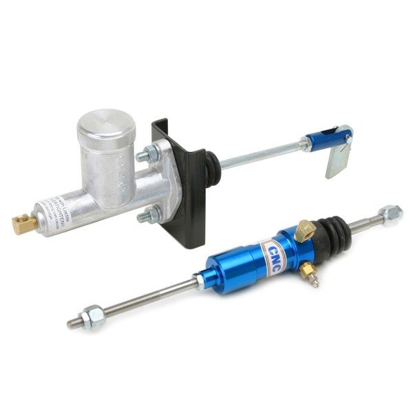

The most common thing to use is the dune buggy hydraulic set up.
I saw one of those on a trike at my mechanics. It is a clean set up and I like it a lot. But, I have just about got everything set up so the dog and I can travel a bit. With my serious lack of mechanical ability I decided that I can fix a broken cable on the side of the road easier than I could work on a hydaulic system. Also, with a real limited budget, I can carry a spare cable a lot cheaper. I'm wondering if I could make a cable with the right ends and to length. It would make a road side repair much easier. Thanks for your time
Hard to believe nobody makes a "shortened" clutch cable:Shrug:
As others have noted above, the hydraulic setup is really the way to go for trouble free operation...
