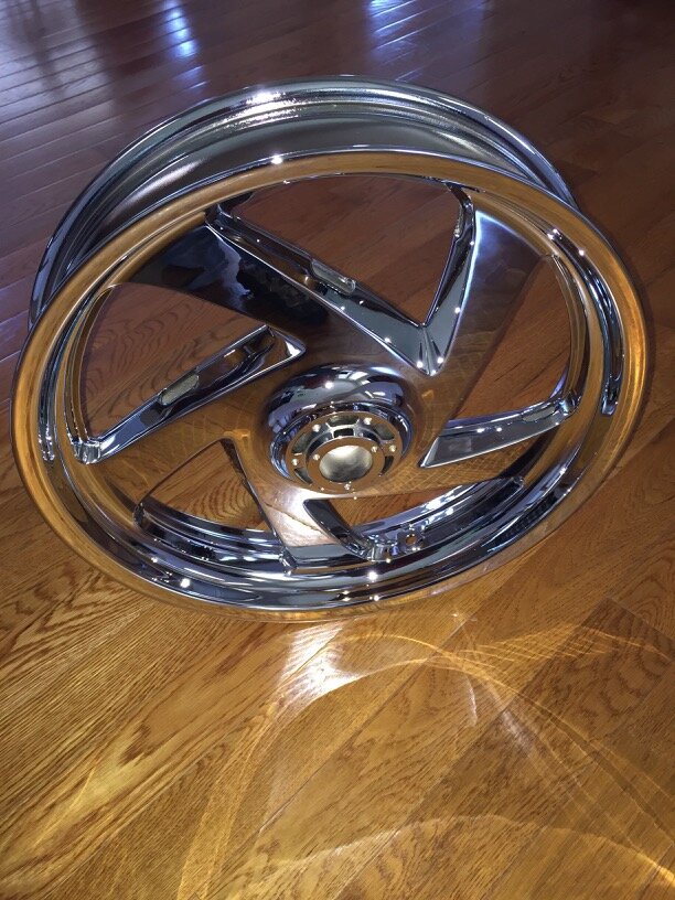

I just got my wheel back from being chromed.
Here is a photo after it arrived.

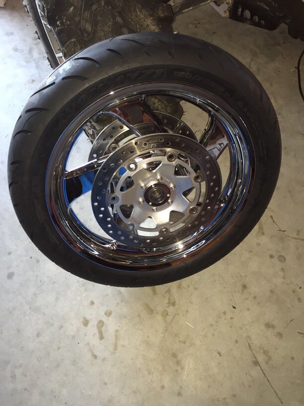

And after I installed the valve stem, bearings, rotors and had the tire mounted.
I used Classic Chrome Plating in Santa Ana, CA. There are the shop that most dealers send their wheels to be chromed. Several chrome plating shops here in Tennessee recommend them as well. The cost for a GL1800 front wheel is $285 + 4.9% waste fee or a total of just under $300 delivered back to you, including shipping . You have to pay only for the shipping to them. They are currently running about 3 weeks, however they completed mine in a week and a half. The only thing I had to do was to tap out the rotor bolt holes and grind down the bearing races for a proper fit of the bearings. A small flapper wheel attached to a Dremel worked wonders, but this is a finesse job with small amount of removal being done at a time. Take too much out and you have to start over again. You will have loose bearings and would have to send it back to be rechromed. It's like cutting hair, you can't put it back. Here is what it looks like:
