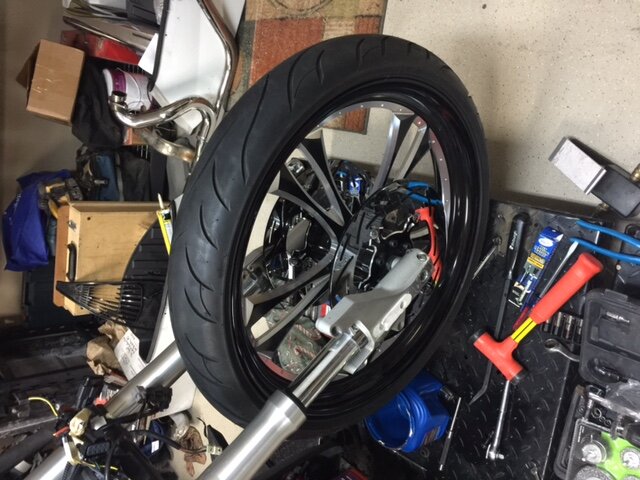

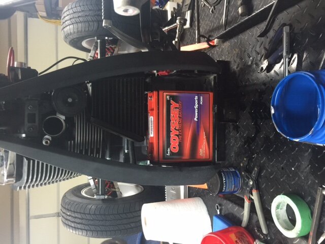

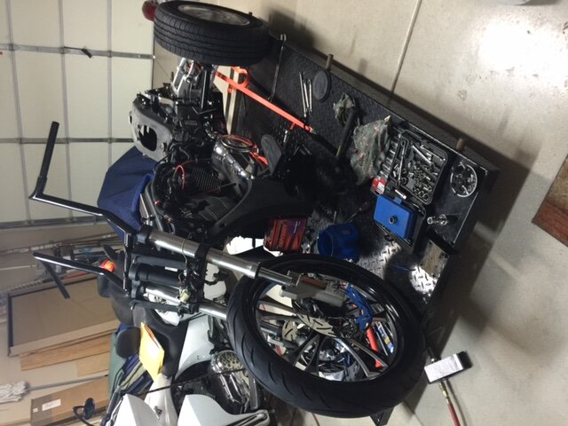

Thanks. I emailed Rylan at the Vic Shop and Kevin at Southern motor works. We'll see what they have. I'd like to have it roadworthy by the 1st. Waiting for front brake rotors to match my wheel and I had to order a new battery box as the old one was trashed from the wreck. Not my wreck, I bought it as a salvage. Once it's finished its off to paint.

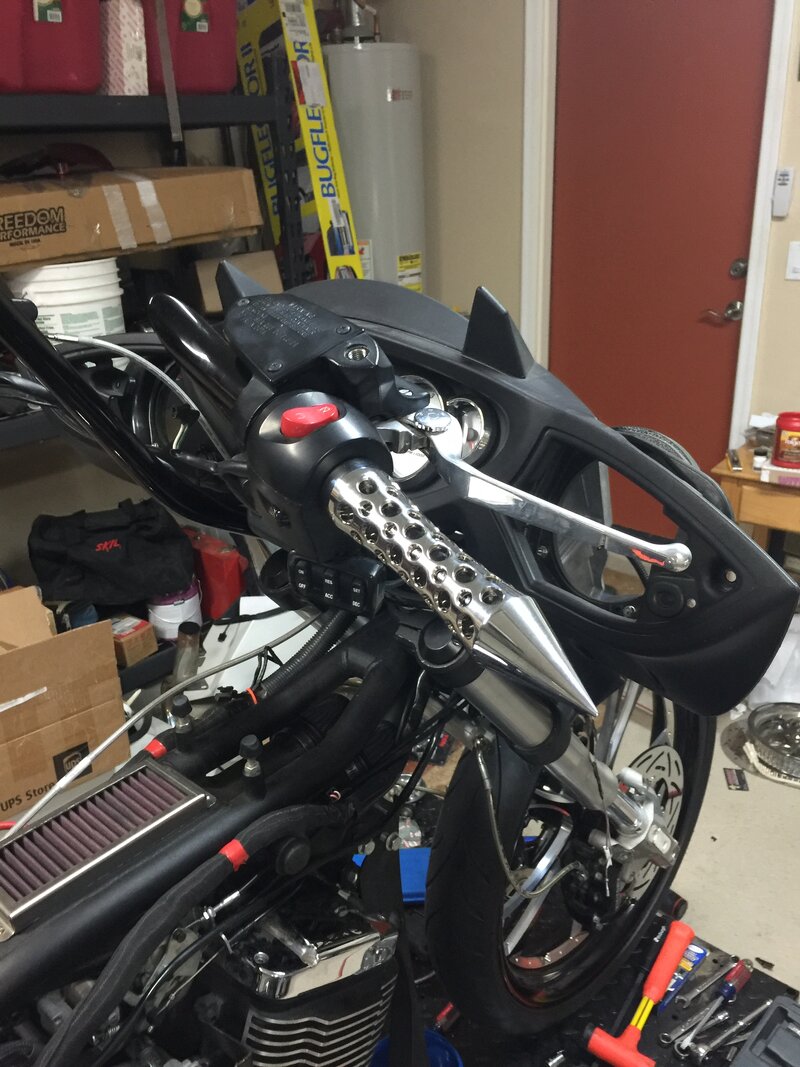

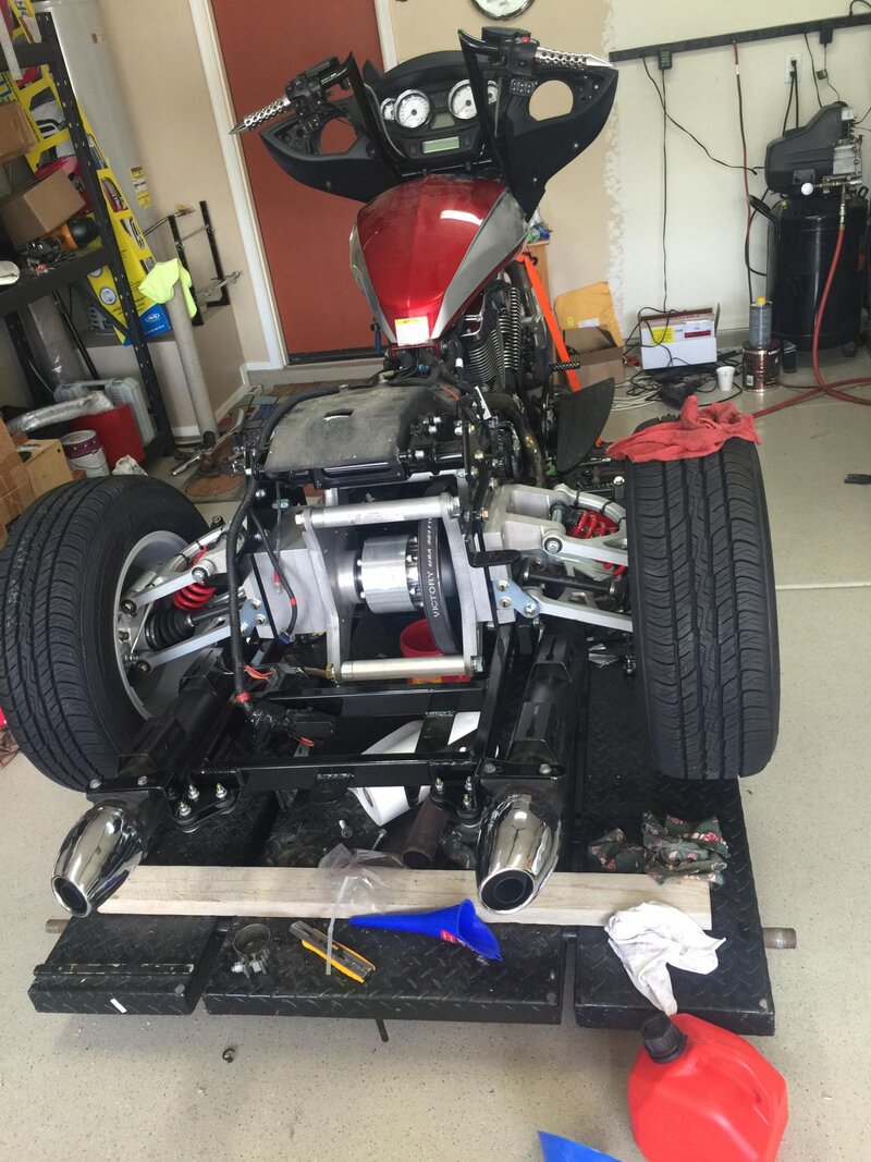

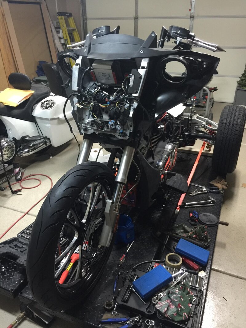

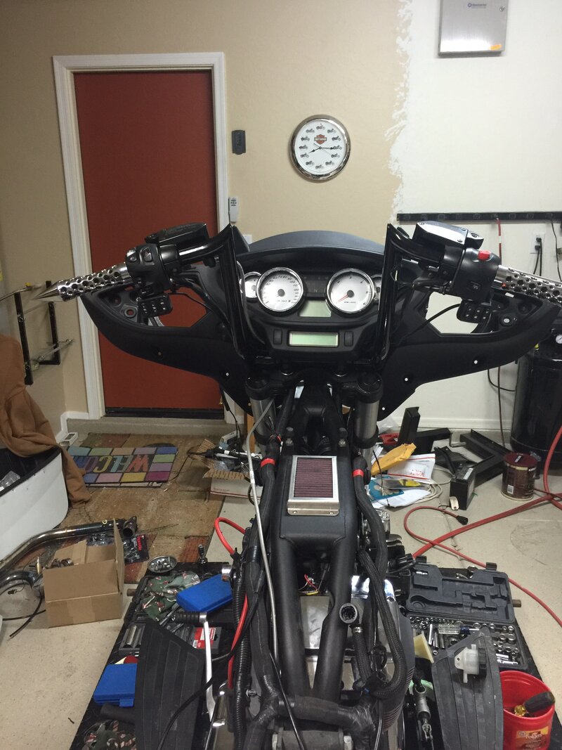

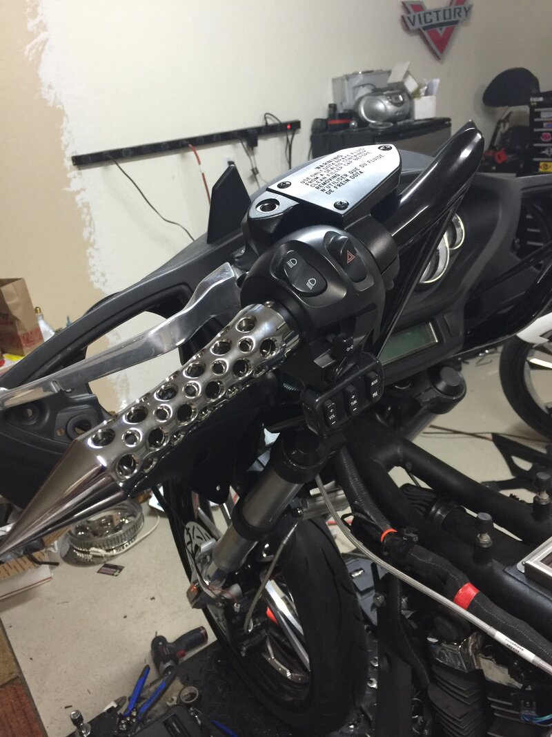

A little more progress. My grips weren't fitting the powder atoned bars. The grips are 1" ID and the bars are 1.17. I had a buddy turn the grips to 1.02. I wanted to see the black bars through the grips so I wanted to save the powder coat. Work out great! So controls all installed. Hydraulic clutch installed. Front calipers installed. Have to run for a longer brake line from the T to bars.
Fairing installed and wired back in.
Getting there.

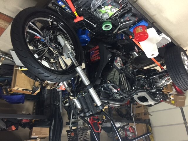

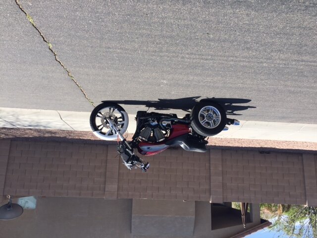

SHES A RUNNER! Fired it up today. runs great and fired right up. Have a small oil leak to chase down. Brake and clutch bleeding is giving me headaches. But I'm so close I can taste it.
Well I took it out for a test ride yesterday. Just a short ride around the neighborhood. Handled crip n clean. After all my brake bleeding fiascos it's still mushy in the rear. Front is perfect. Hell even the hard to bleed hydraulic clutch is work g well. Now I just need to finish up some wiring, install my amp n speakers, air ride, reverse and hang the body. Oh and bleed those damn brakes again. Argh!
