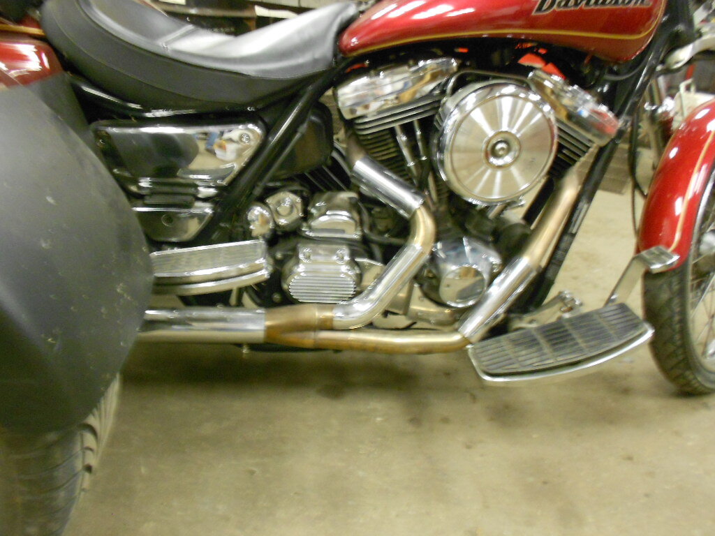

I have a Supertrapp 2:1 on my FXLR.
My kit is a Lehman but they are similar.
I mocked up the exhaust for routing and length and bought a piece of stainless exhaust (proper size) on eBay.
It was already bent 180 degree and I cut the middle of the bend and made an s-pipe.
It works and nothing hits.

Just an example:

Lee, thanks for the links and picture.
Is that a ss trap or cs? I do not have a tig welder.
What if anything did you do for a heat shield?
Did you have to change or modify the mounting bracket?
That offset looks like a pro did it. You are a talented man my friend. Thanks DAGO

I was able to fit it without modifying the collector tube.
I have a Stainless version of Supertrapp that is no longer made.
The heat shield was a modified heat shield that I had hanging around the shop.
Just dresses it up a bit.
Your exhaust is mounted to the engine, so any brackets need to be free-floating.
I used rubber bushings on the rear hanger.

I am running between 16 and 20 discs. I had a racing cap on it and put the standard one back and added 4 discs. I haven't run it enough to read the plugs or even do a real tune on the carb and timing. No DYNO for it yet......
