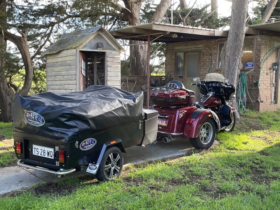

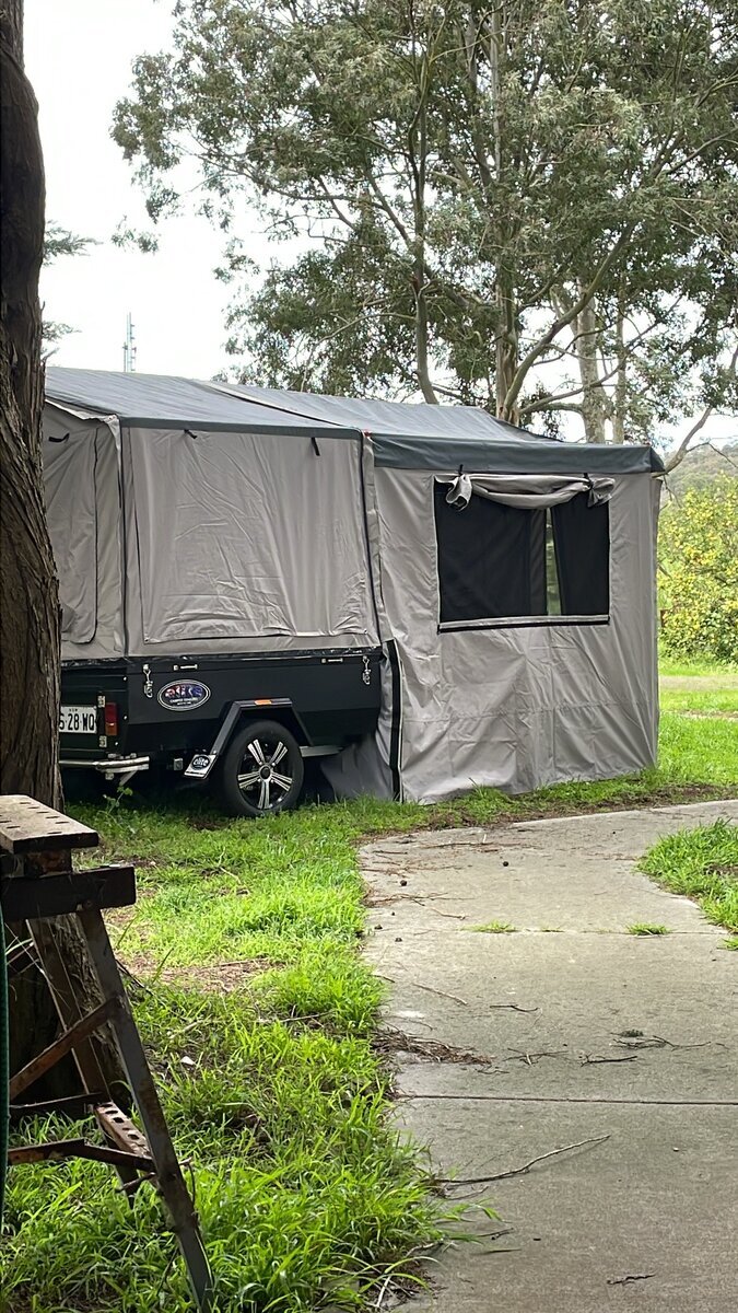

I'm just starting my trailer journey, this is the first bike I've towed anything with.
It tows well, and i keep longer breaking distance from vehicles ahead of me.
Trailer has own hydraulic brake system., yep, drops fuel a bit and i had to explore gear/speeds to suit the extra mass. Once i found that harley, loping sweet spot fuel changed from 8.3 litres/100km (5th 115kmh) - down to 7.1.L/100km it was 6th gear 105 kmh for that rig on the highway.

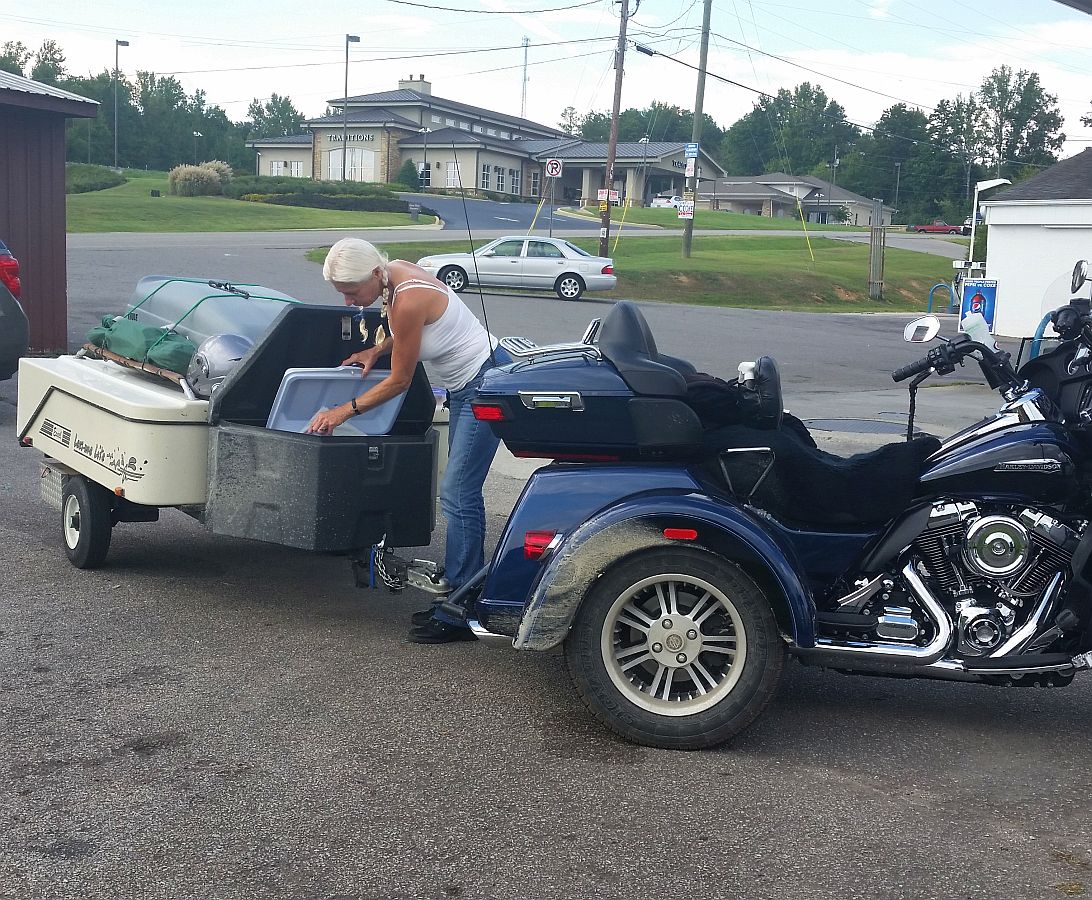

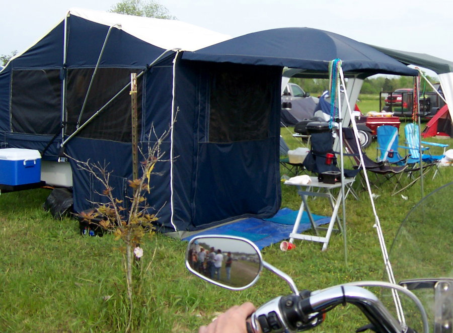

Some food for thought. We have well over 100K miles pulling a variety of trailers behind HD Trikes.
Kept the tongue weight on all of them between 25 and 40 lbs (tested with a fish scale).
Cargo trailer, fully loaded was in the 250 lbs area.
All the pop up tent trailers were in the 450-550 lbs range, fully loaded.
The weight and the wind resistance make a significant difference. MPG drops 20-25%, because there is much more strain on the powertrain.
The Bunkhouse was the worst for wind resistance.
Below is a photo of our Bunkhouse, fully folded out.
Our Bunkhouse weighed 395 totally empty
Our Time-Out weighed 345 totally empty (and had the highest profile)
Our Leesure Lite weighed 295 totally empty (and had the lowest profile) (it is the one pictured above)

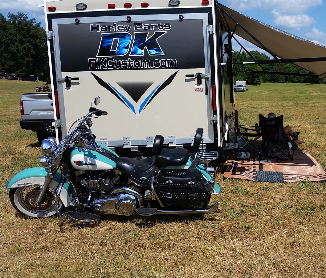

Yeah, I hear ya.
This has been our progression:
Carrying a small tent and bed gear on the sissy bar, to...

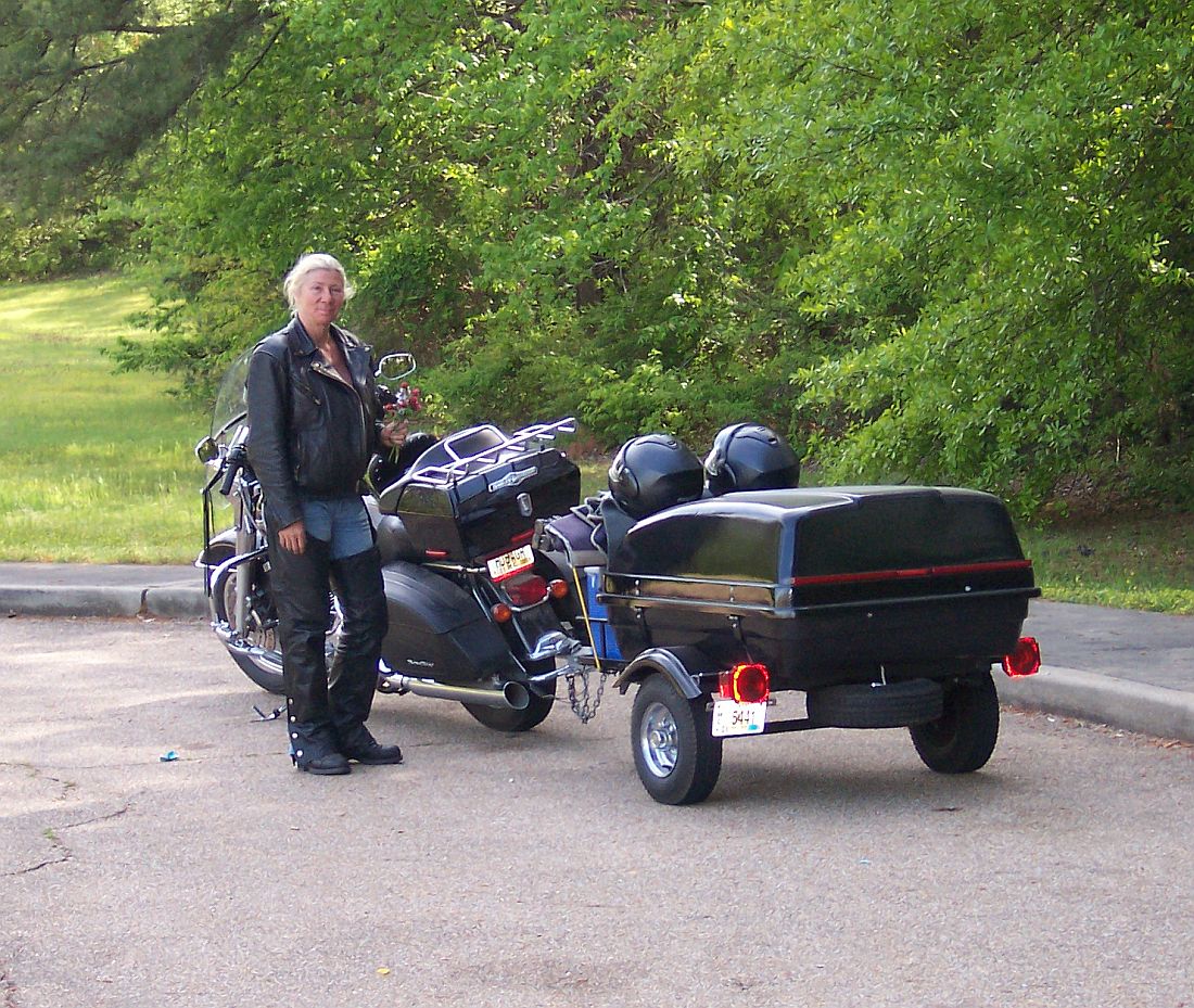

A Cargo trailer that carried a bigger tent and chairs, and whatever else Mary packed, too.
3 different pop up tent trailers.
Then after Mary had 2 different heat exhaustion episodes, one in 2016 and another in 2017, while traveling cross country, we got a Toy Hauler to eat up the long straight miles until we got to mountains and curvy roads to ride.

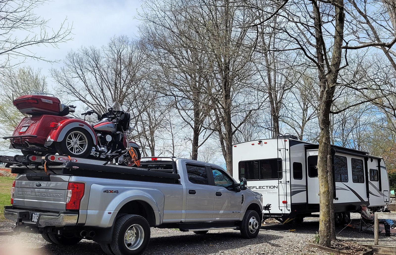

Our latest iteration is a deck on the bed of the truck for the motorcycles, and a travel trailer.

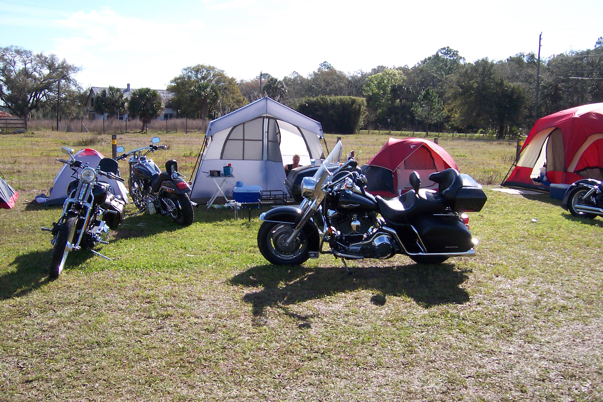

Daytona at Cabbage Patch, circa 2006 with cargo trailer and big tent.
Already posted pics of tent trailers.
Toy Hauler, circa 2018
Earlier this year with Trike on truck deck
