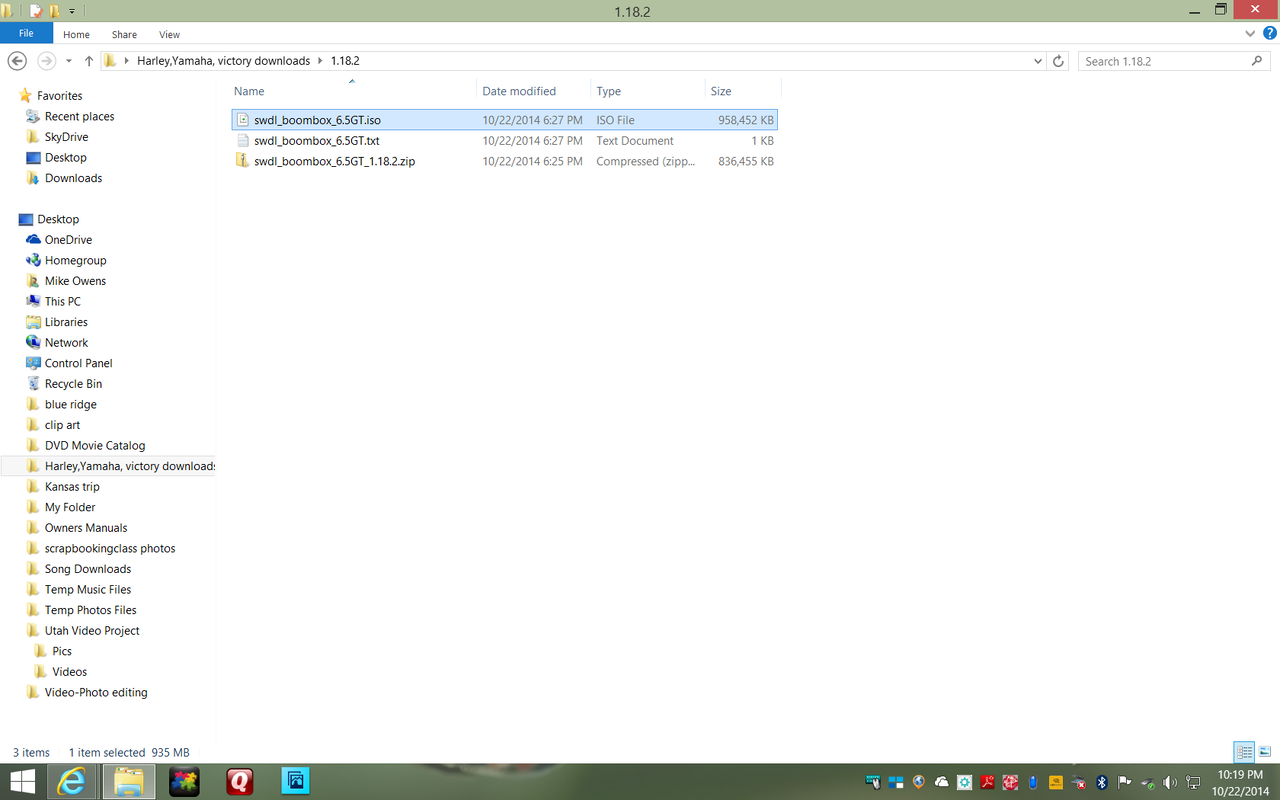

I have looked at both those files and do not see anything that would tell you which version you are using. I see the version number in the zip file folder. I do know that all the update files are always have the 6.5 because it tells you which boom box it is for but the .txt file and the .iso file have the exact same file name
OK, now I feel like a dufus. When I click on the txt file it opens and shows me the info. I always have created a new folder for each update and named the folder the version of the update. Thanks for your help.
Sorry I was not clear ..... Yes both files when unzipped are the same name as previous versions.
I read the txt file. It has the P/N and version in it. ThumbUp I do several of my friends updates so I have a few drives.
