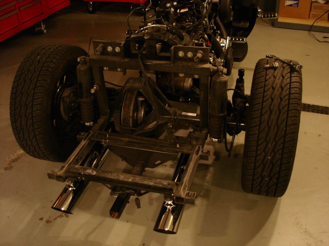

Pictures here, Post 7 and 9. http://www.triketalk.com/forum/threads/19269-Changes-Made-to-TG

Thanks for pictures Dennis . One question where top of shock is bolted to cross member , there appears to be 2 bolts and a sleeve or short tube , is there a bolt for it too ? Oh by the way have you ever seen any 2011 TG'S with the body canted to one side ? Dealer says they have seen it before they adj. it ( no charge) but there is still a 1/2" difference right to left at the bottom of the fenders measured from floor to fender .
The top of shock is held with bolt going through shock and threading into frame (cross member) if I understand your question. On body adjustments, someone else will have to field that, never personally had the problem.

First Thank you Dennis for your reply , maybe I didn't write that question clearly . Shocks attach like any motorcycle shock 2 bolts 1 top 1 bottom, the cross member its self shows 2 bolts on the right 2 on the left ; to the outside of those are what appears to be 2 short blank studs or tubes , are these mounting points for the body ? Does anything attach to them by way of a bolt , I am assuming they are body mounts of some type , if not what are they there for ? Thank You again Dennis for your help, Greg
Bolts come through body in trunk and attach there. They are threaded bosses. You should be able to click on picture to enlarge and then click again for even better picture. Hope that clears it up better.
