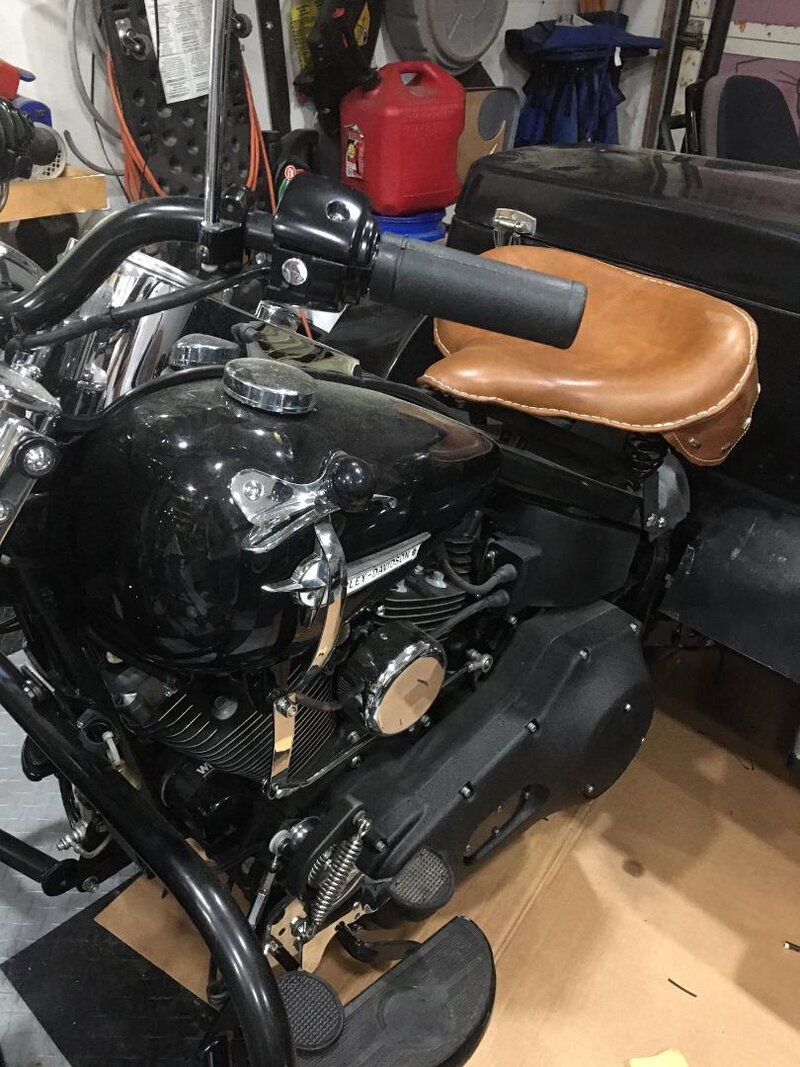

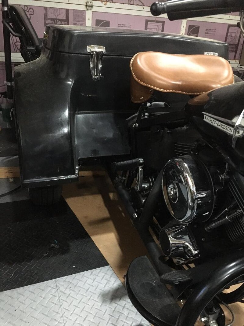

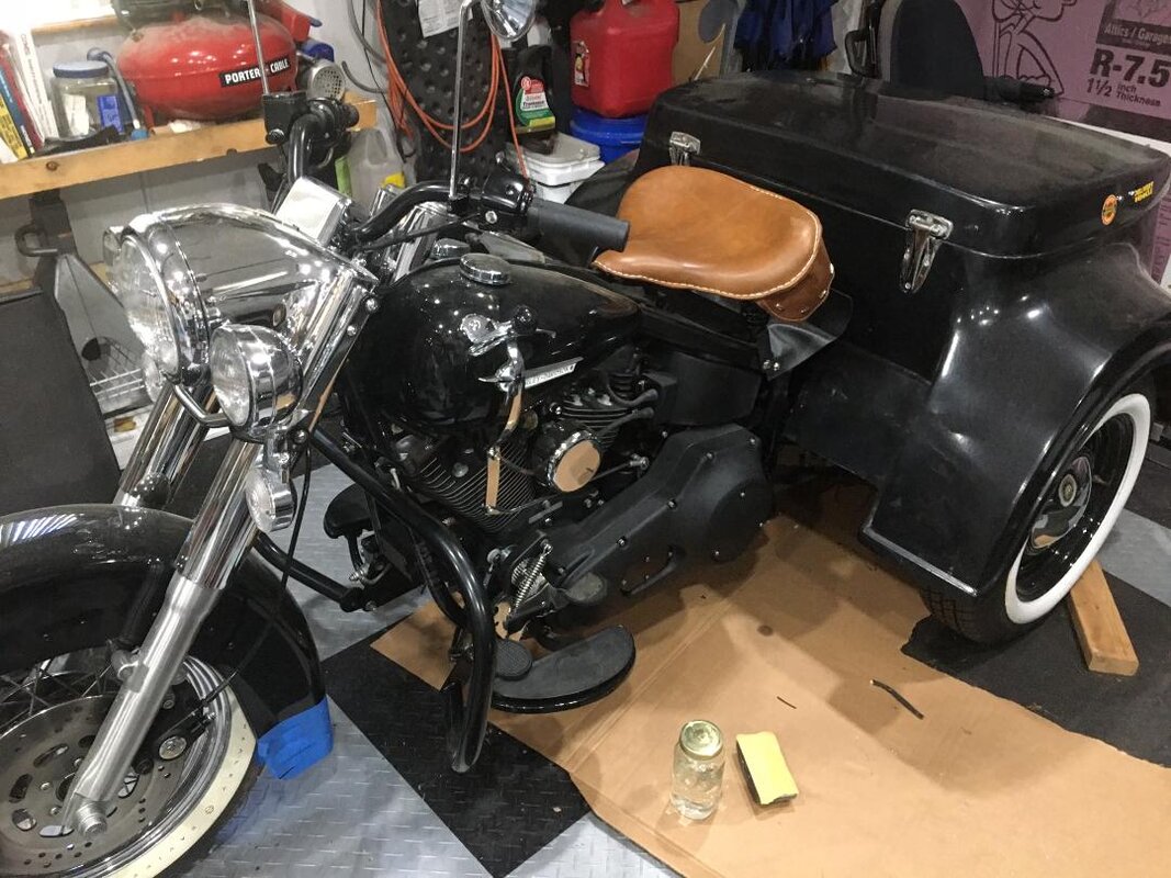

Hoping that somebody might be able to give me some ideas about relocating the stock Softail "fuse" box. Normally located in a cutout in the stock rear fender. Thought about mounting inside the body but it would require a fairly large hole to be cut into the front of the body. Sure would appreciate any information.
I should have been a bit clearer. The fuse box is actually a circuit breaker box and has a relay or two in it. 1998 Harley Heritage Softail. Evo engine, carburetor.
Fuse block
Right about the fuse box being mounted into the Softail rear fender. I no longer have the stock rear fender on the Harley. Anyway, I made a cutout in the front of the box and mounted it similar to the way Harley kad it. Now it's behind my seat and I am covering the fuse box with black vinyl.
Not done yet, but you'll get the idea from the attached pics.
