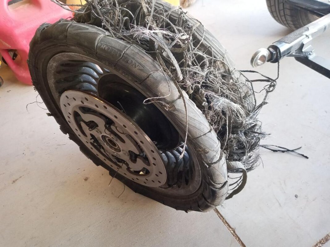

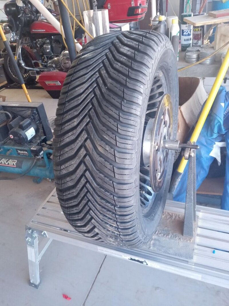

I was able to get the Rear blown tire to day here are a few pic's nothing else happened the rest of the bike is fine. The old one was a Dunlop, this time I'm going back to a Michelin Tire CrossClimate 2 205/55R16 91V All Weather Tire. the last one worked out great till I got a 3/8th inch bolt in it. once I get it on I'll take some more pic's.

Curious - looking at that tire - could it be that since you are using a voyager kit, at times, the bike rear tire is moving, yet barely touching the ground.
As a result, you are like spinning the wheel like doing a burnout.

My next question now:, is how can a tire get that bad, for a immediate blow out??? It appears, that the tire had been flat a long time and he was drive'n with it be'n flat for many miles (??) I'm surprised :unsure: that the operator of this bike, couldn't hear the blown tire, thrashing around under him, with the tire being in that condition (???)

I just checked the tires front and back only 2 days before, after I looked back to see when I put that tire on the bike and it was 8 yrs. ago. and 28,000 miles.

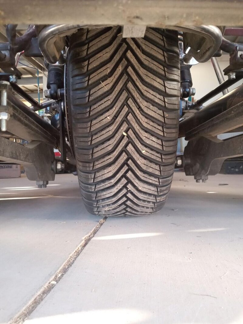

Installed the new tire on the bike today, everything fit right and I will take it out for a ride tomorrow. I have to worm the tire up to get the ride on to do it's thing. they say it may rain tomorrow morning. we haven't had rain were we live about 70 mile south east of Phoenix, Az. in Hidden Valley 17miles south west of the town of Maricopa. all the rain seems to go around us.so we hope we get some tomorrow.New Rear Tire.jpeg
OK. I took the bike out today for a long ride (50) miles (not that far) and all the small problems I had that now I know that they all stemmed from the old rear tire that blew out on us. it rides smooth, no wobble at all and it handles better on the highway and in the turns. I'm now happier them when I first installed the voyager kit. the weather has cooled down & it's time to ride! it's been 110's hear all summer, but the wife never said no to getting on the bike to go for a ride, we're getting on the bike tonight for a ride and a few drinks.
