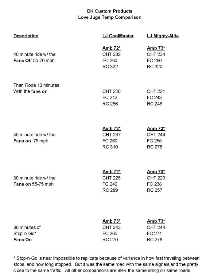

I can verify the Mighty Mites fans have lowered my M8 engine temperature at least 30 degrees
I am betting the larger Love Jugs fans would lower the temp even more;)
Jack I believe the Mighty mites are the best. I think it has been proven. However they are without a doubt the best heat management tool we could have purchased. PaPa Zook did us well.... ride safe Fred
I would suggest giving DK Products a call. Along with the mighty mites I bought from Papa Zook I added some other items from DK which would be oil cooler/relocation kit and tank lift (1.5 inch). This summer on the hottest days the combination of these items kept the highest oil temps at around 235. I own a 2016 103 T/C. Welcome aboard. I am not a rocket scientist so keep in mind I am just an old scooter tramp that went to 3 wheels. hope that helps.
Here is a chart on the Love Jug Mighty Mites that you can get from Zook at this LINK.
As you can see, the Mighty Mites cool a bit better than the other versions of the Love Jugs.
Key to the above chart:
Amb= Ambient Temperature at the time of the testing
CHT= The front cylinder head temperature as measured by the OEM factory sensor, and displayed on the Power Vision as ET
FC= Temperature measured with a heat gun, directly behind the spark plug on the Front Cylinder
RC= Temperature measured with a heat gun, directly behind the spark plug on the Front Cylinder
The fans do a very good job at cooling down the engine temps. There are additional things you can do to get the temps down even more, for better performance AND Comfort. You can see a full Report on why and how to cool down your Trike at this LINK.
