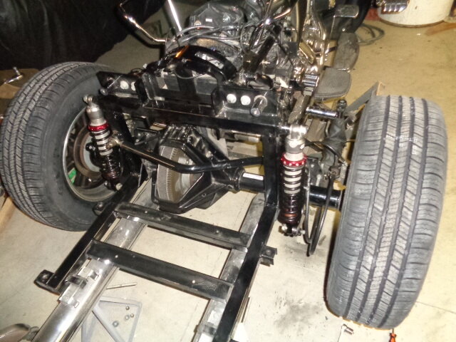

Coil overs will help, however my 2019 still doesn't take the bumps as well as my previous 2 wheel bikes. Riding in Florida and a couple other southern States that have nice smooth pavement is the key IMHO. Illinois, Michigan, Wisconsin and a couple other northern states just don't maintain their roads anymore and it makes for some rough riding no matter what your are in/on.
We ride 2 up probably 99% of the time. My 2019 has been modified with the 14” lift and PA shocks set up by DK. Rear tires at 22. Ride is about as smooth as it gets. Are there bumps? Yes, but no worse than a car. Cadillac? No, but I didn’t buy a car. We can ride as long as we want, no 3ft waves here:D.
You’ll have to invest some $$, but IMO totally worth it to enjoy the ride. Like others have said, call DK, they shoot straight.

Congratulations on the new to you ride. Welcome to the forum, as others have said Pro Actions are the way to go, pricey but worth every penny. We rode ours for 6 years with OEM air shocks horrible ride! rear tires at 22 lbs. we avoided some areas because roads were to rough. Cross reflection joint bumps in road being the worst and railroad crossings. When presented with an opportunity, I made the investment sorry now I did not do them before now. I also did the front forks now our 09' Triglide now runs like a sport trike it handles so well.:) There are less expensive shocks than Pro Action but the old saying goes Cry once and get it over with!!! you will not regret it. :D Ride safe good luck on your choice. Fred
