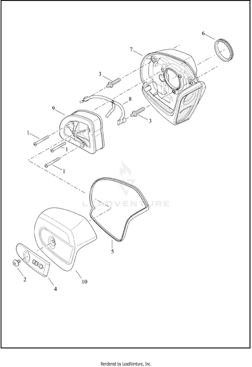

There is a metal purge tube on the top of the throttle body. It should have a rubber cap on it. Maybe it was damaged or knocked off during the air cleaner change. This will act like an intake leak.
#4 in this diagram

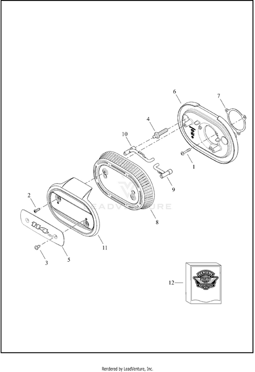

Ok everyone, took my bike out today and did everything I’ve been talking about. Said what the hell, took it home swaped air cleaners to the old one. She sits there and purrs like a kitten. Only thing I can think is if I’m using that high flow air cleaner I need some type of a tuner.

Hey guys, sorry for taking so long, but I finally got everything straightened out with my air cleaner. Stupid me, all I had to do was take the top bracket from the stock air cleaner off and everything mounted up perfect. And yes it runs great. No problems with back firer or sputtering off the line. I’m looking for a FP3 to fine tune and change the rev limiter. Thanks for all the advice as always Rich
