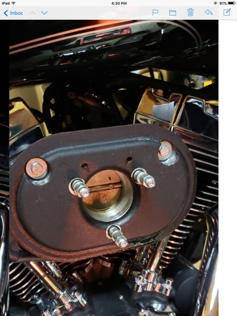

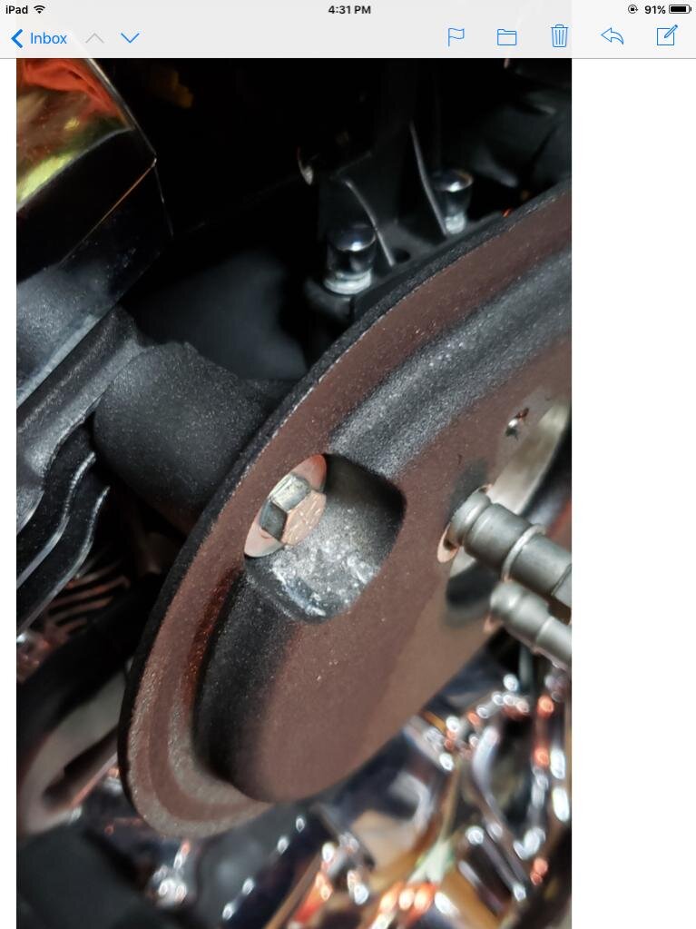

I'm contemplating adding EBS , but looking at the kits from DK customs, they don't seem to fit my air cleaner, the oil is coming thru the holes right above the intake as seen in this picture, has anyone done this modification? Lots of oil inside I would like to get rid of
View attachment 83691View attachment 83692View attachment 83693
You are going to have to drill and tap the stand offs on that backing plate to set up a breather for that set up. Give Kevin a call@ D K Customs. He has a set up and the tap you will need
