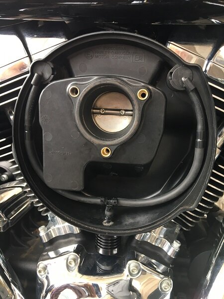

Stock Air Box Back On Re-Did, Re-Rout EBS Catch Can Set Up
Update

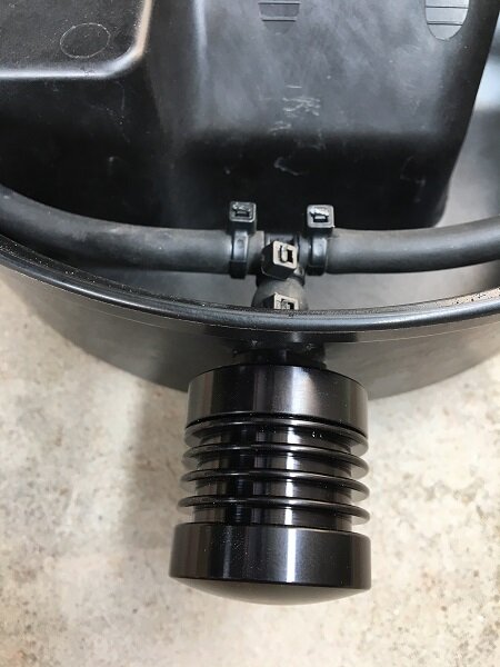

Well after another 50 miles the oil has showed up at the end of the hose, just like all my other bikes have done, No oil showing on the frame and after sitting all night not a drop on the floor, My other rides would always leave a drop maybe with more miles this will happen. Thanks Doc
Well after 450 mile the bike is marking its spot one drop on the floor today, still clean frame and breathing good, This mod is a keeper. Doc

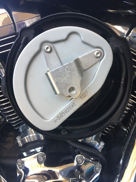

I like the catch can option but I had something happen these past couple of days that makes me a bit leery of the mod. The reason is that the large screw holding on the M8 air filter cover on happens to screw into a brass fitting that is imbedded in plastic in the middle of the stock Harley M8 air filter. I was attempting to examine my air filter to see how much oily blow-by was going into that area with 2200 miles on the clock of my 2017 and the darn brass fitting had stripped out of the plastic. I had to take it to Harley and they did what I think what I would have done which was to have one person pulling on the air cleaner housing and another unscrewing the bolt from the loose brass fitting. If I had done the mod that some are talking about in terms of punching a hole in to the bottom of the metal air filter housing, I am not sure how receptive the dealership would have been to performing the work under warranty where they subsequently ended up replacing the defective air filter and did not charge me for any labor to do the repair.

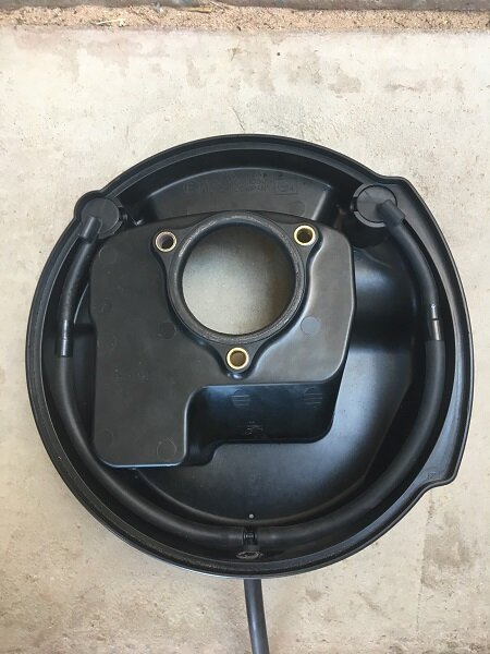

The hole in the bottom of the air box is drilled through plastic. The factory air box is plastic only the air box cover is metal. All the guys at my Dealer here in California includeing the owner thinks the mod I did is great.
A few of them are thinking of doing it to there own M8. The hole in the bottom of the air box is really no big deal and really no diffrent than a drain hole and causes no structural damage.
With that said, every dealer is diffrent. I don't think this mod would be an issue but I could be wrong.
I have had my AC cover off a lot with no issues. It makes me wonder if your AC cover bolt was overtightened or possibly cross threaded a little from the factory.

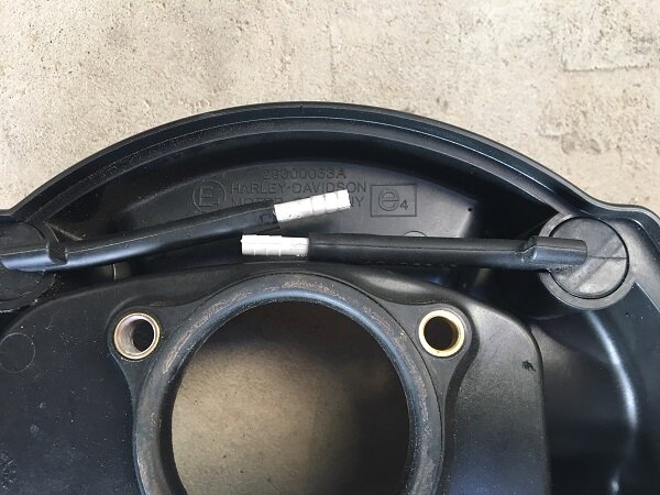

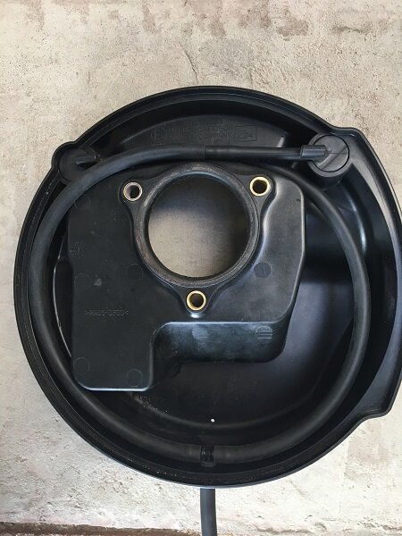

OK I did your mod,
Like your mod. My air box is different so my mod is just a little different. Only needed two hose connectors and hose. I did made a change to the routing of the hoses by filing to new places for the OEM hoses to be routed down the sides of the air box (rather then across the top) using the hose connectors and hose to the OEM tee at the bottom air box where I drilled a hole to exit hose.
Will install a small catch can when I get it. Will I have to re-route the hose that laies on the engine housing because of heat melting it?
