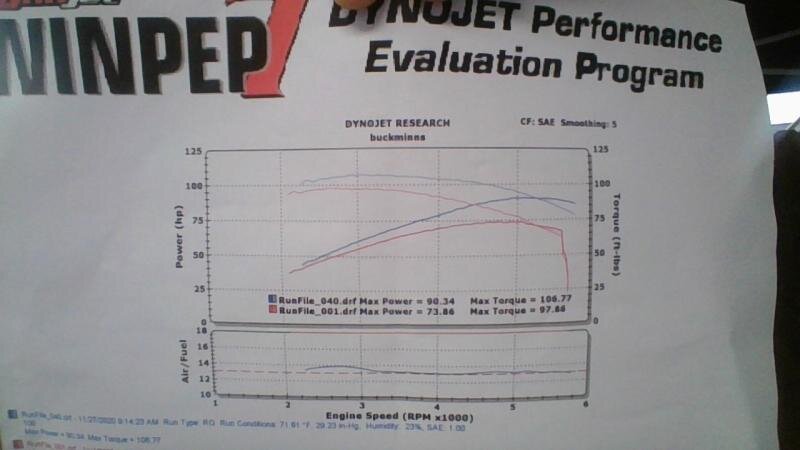

Typically HD's torque and HP numbers are measured at the crankshaft. My 2017 trike with a 107 measured 96 FT LBS of torque on the dyno with a stage one air cleaner, SE mufflers with stock tune. The biggest gain will be a good cam designed for torque, now choosing that cam can be daunting. Your best bet would be to call Bob Woods and talk directly to him, that is what I did when choosing a cam for my 02 Road King. On my trike I watched some cam comparison videos on You Tube from Moonshine HD that were M8 specific.
And I couldn't be happier with both choices, a trike will normally have about ten HP and torque lower than a two wheeler because of the parasitic drag of the rear wheels. Below is my dyno sheet on the trike so notice that at about 2200 rpm it already has a 100 ft lbs of torque compared to what it had in stock configuration.
