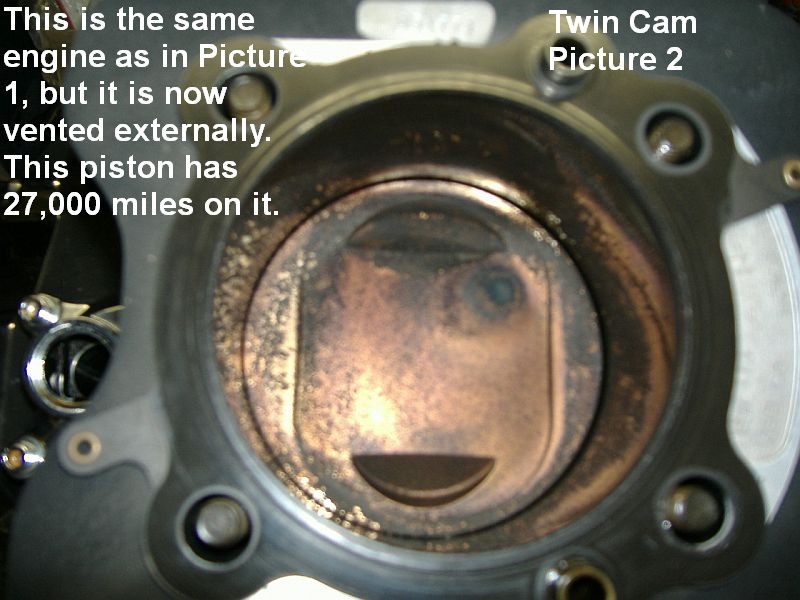

They are not necessary, but your engine will run stronger and longer with one. Here is what the inside of an engine looks like when feeding that hot, oily, oxygen depleted air back into the intake-
Here is the same engine, after being cleaned up and an EBS installed-

Thanks Kevin. Great information and videos regarding what happens to the pistons. Very ugly. That is the company I was going to use for an ESP once my OEM warranty runs out in Feb 2021. Truly appreciate all of your help for all of us on this forum.
