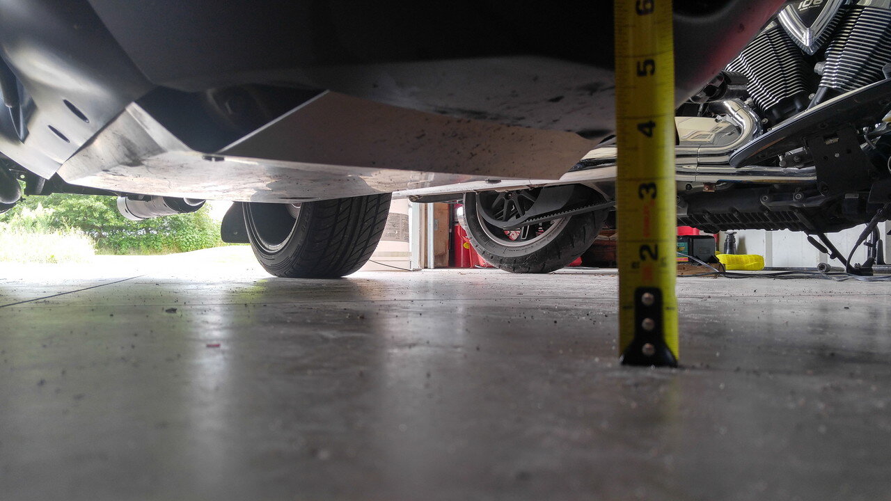

Curious what your clearance is from the ground to the bottom of the lower front cowl?
Mine is 5".....It's lower at the belly pan.

I'm thinking mine is a little lower in the front also....but it tracks and handles great!0812191555_HDR-picsay.jpg

I'm thinking mine is a little lower in the front also....but it tracks and handles great!View attachment 75099
I cam measure it this evening. My trike was so low that my floor jack would not go under it. I had to run front wheel on a 2x6 so I could get jack under it.
Well I guess I don't know how to load a pic from my iPad. The bottom of the cal is 6-1/2" off the ground. One of the tubes spacer is 4-1/4" long x 1-1/2 OD and the other tube spacer is 7" x 1-1/2 OD. I did not take pics of the assembly. I cut tubes that are 1-1/4" longer than these stock lengths. I think my pics are to large to post and I can't seem to resize them.
