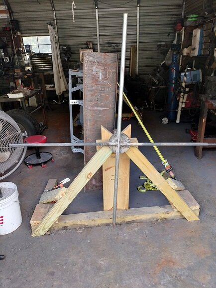

While working out with my son last night in the garage we were looking at the trike on its side and I noticed something.
The straps I have holding it in place I do not think they are reversible, So I cant let the trike down easily with the straps.
I'm headed out to get some Argon today so I will look for reversible straps. If I cant find any I may have to order online.
I could use the floor jack to lower it down but to be safer I would like reversible straps

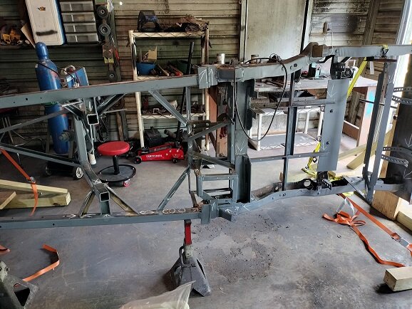

Now that the heat has let up I was able to get out and work on the trike. I thought I finished all the welding and fabrication I needed to then found 1 more bracket I needed to fabricate. I will do that the next time I can get out there.
Then I have to go back over it 1 more time to ensure I did not miss anything, clean up every thing and put some primer on it just so it will not rust.
Then I flip it onto the other side and do it all over again.

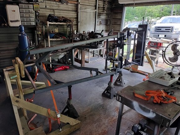

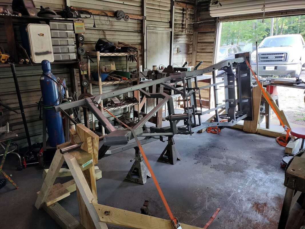

Its on its other side now. I marked it up everywhere I can see that needs some work/welding/cutting/fabrication
If I was to make the rotisserie again I would do it a little different. The main thing would change is i would link the 2 end with 4 2x4s. Rotating the trike to the other side shifted the rotisserie around some.
I started working on this side now. Its still hot out and I cant have the fan blowing on me because it affects my welding. I assume it blowing the shielding gas away. It took me a few to figure out it was the fan causing the issue.

I was able to get some more work done on the trike the other day. Still a lot to do.

On the trike there are 2 spots that really look bad. Not week just ugly. There must have been something big welded on each side there. I tried to clean it up and hide the ugliness on 1 side but made it uglier. Again not week spots just ugly. I have not decided what I will do. I guess I could just cover them up with some steel.
Started back to work on the trike yesterday. getting ready to go back out again today.
A while back I removed the leaf springs and installed coil springs. I cut the brackets off but they look like crap so I am no making and welding on coverup plates.

I finished all the basic welding on this side now. I just need to make 1 support brace and then do a good cleanup and primer.
Then I have to flip it back to the other side and make the plate and brace for it.
After that I should be able to turn it right side up and start remounting things
