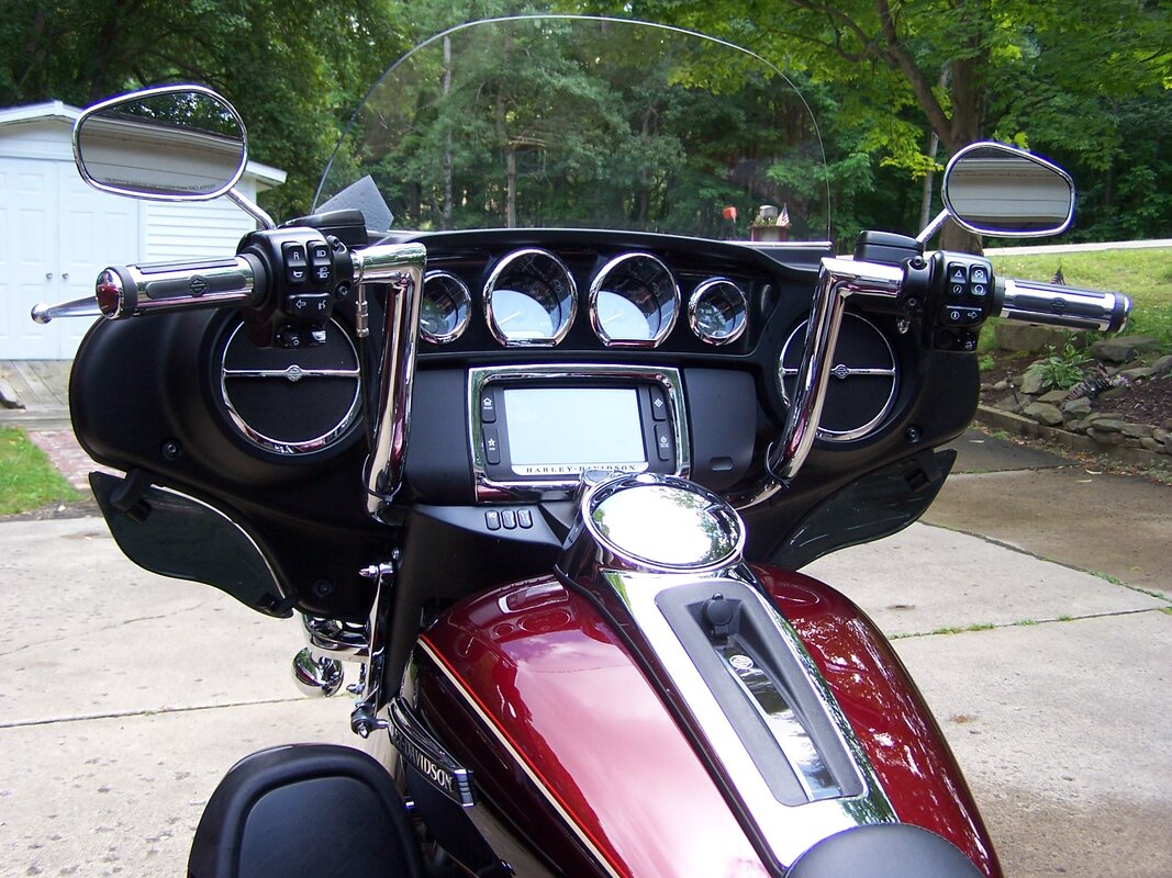

Would think so. So here is my dumb question ,after reading the install, you used the wide sweapers, did all of the existing cables fit ? Did you get the true 2" pullback needed ? Those bars are wider than stock, so steering should be easier leverage wise. By the way, great post:GoodPost:
Every thing fits perfect , but i'll tell you if it were an inch longer i would have been in trouble lol , ohhhhhh another important thing , the TBW plug on the Tri Glide didn't have to be torn apart it went right through the bars without taking all the wire loose from the plug.
Good to know, that's all I need is the 2" longer pull back. Was waiting on your final post b4 ordering. Thanks.
im new to working on bikes but i have built numerous hot rods and engines, so when they told me $800 & $1000 i knew i had to try now i didnt start it up yet so im keeping my fingers crossed
i live in South Louisiana and the weather here is crazy 32 today and was 80 Sunday , but i know i'll get at least a little ride today after work
I'm sure you will like the bars
I changed mine in 2013 and have never regretted the choice. You will be amazed at the ease of turning like adding power steering to your ride. Rider posture is much improved hands don't go to sleep near as fast back and shoulders don't stiffen up. These are what Harley should install OEM, or at least have as new machine option. Great to see you have made the change yourself Congratulations. ride ThumbUpsafely fearless
Glad you got it done. You are right about the wires just fitting; I actually used the 6" wiring extensions to make it easier on me. They were only $24 from Surdyke, but it can be done without them.
I love the bars, the 2+2 wide sweepers were perfect for me; right height and pull back. The extra 3" of width makes the steering much easier.

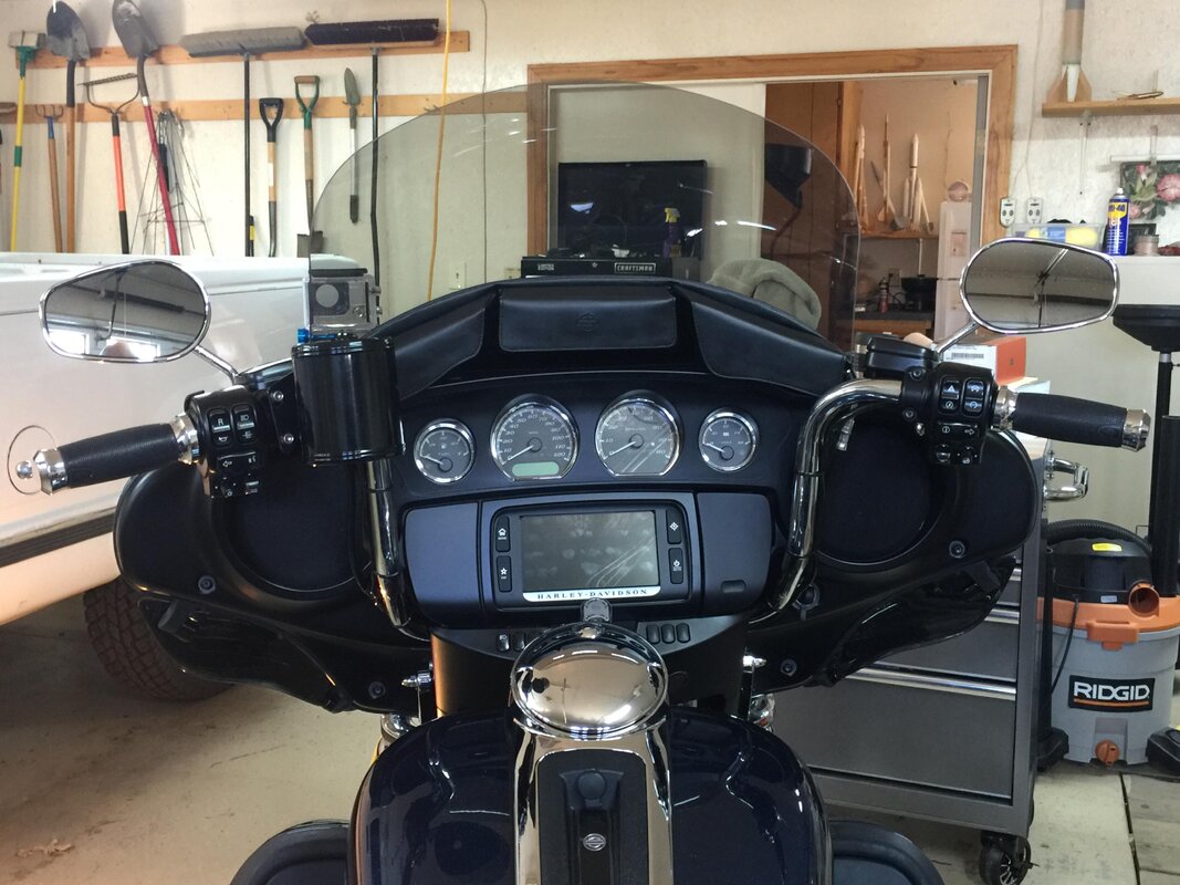

Ok Waldo, got the bars on. The throttle wires were a bitch to get out of the connectors. Ran wires in new bar then reconnected to ends. Took 2hrs to figure out. By removing radio, everything was exposed. Got right side back together, now to adjust. Tomorrow is another day. I know why the dealer charges a grand to do.
wire relocation in bat wing
When plugging everything back in you may need to move position of connectors I used zip ties where needed. just a thought it may help. :Shrug:just sayin good luck not hard just time consuming. By the way what bars are you putting on I must have miss the post. work safely fearless
Krome works 2+2 wide sweepers. Zip ties are my friend. Also use die-electric grease on all connections. Taking my time, only to do this once !
