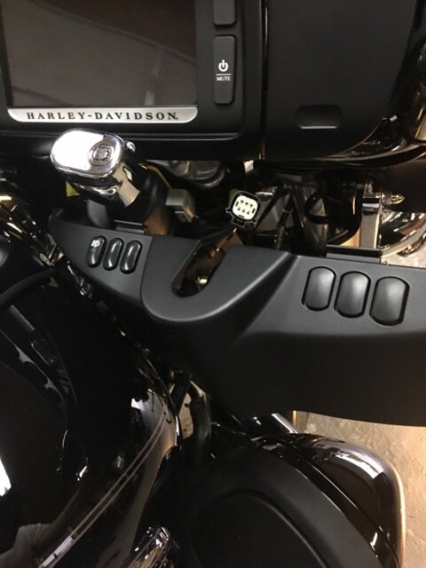

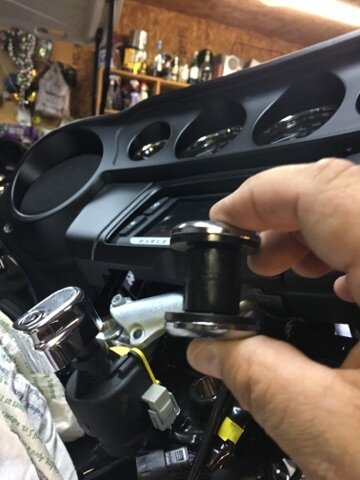

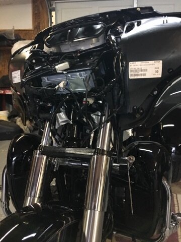

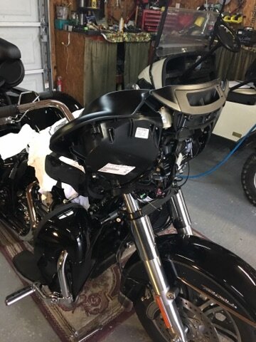

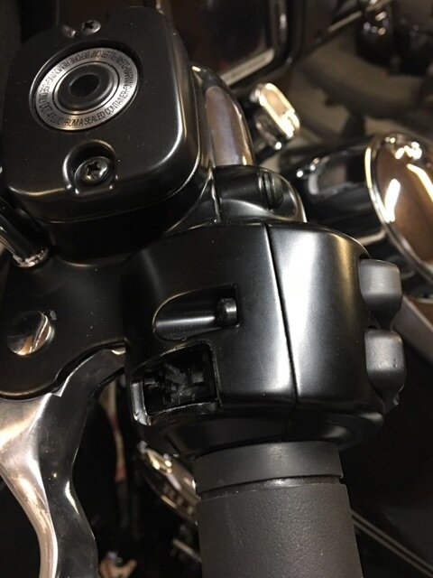

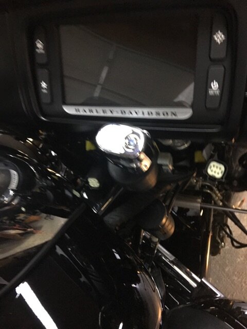

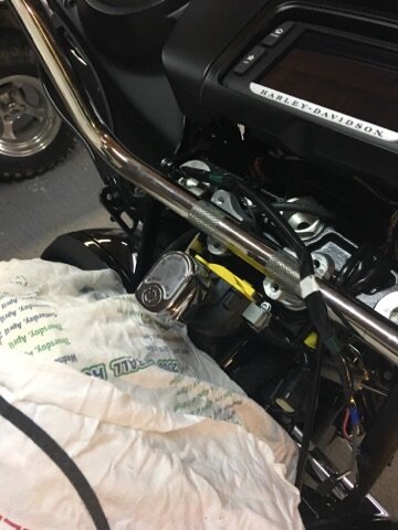

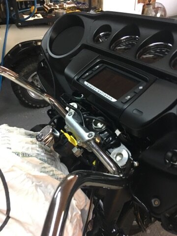

Well i got it took all apart all went well EXCEPT that little Trip Reset Button i broke it but all is good i'll get them to order one and swap it for me the reset still works i have to use my finger, the handle bars will be in today so i'll start tonight and it looks like the TBW wire will slip right through without taking them apart , i took them out the other bars with no problems at all here are the pics, oh i did swap the bushing also got ride of them flimsy rubber ones

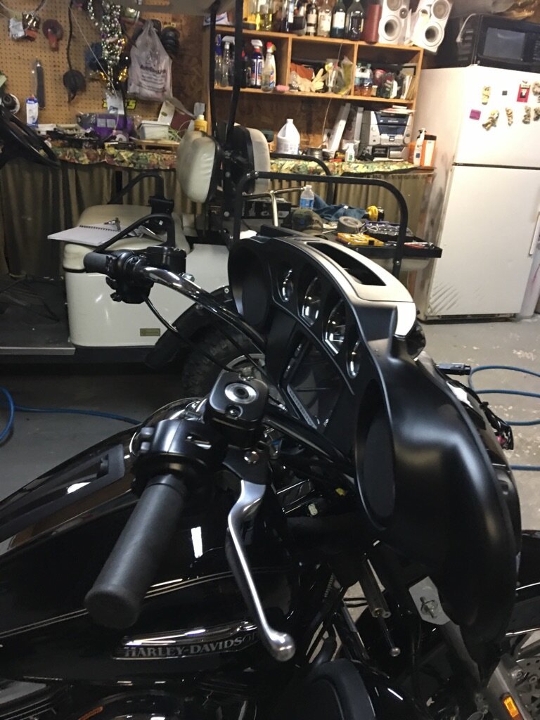

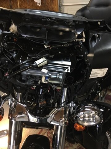

ok here ya go

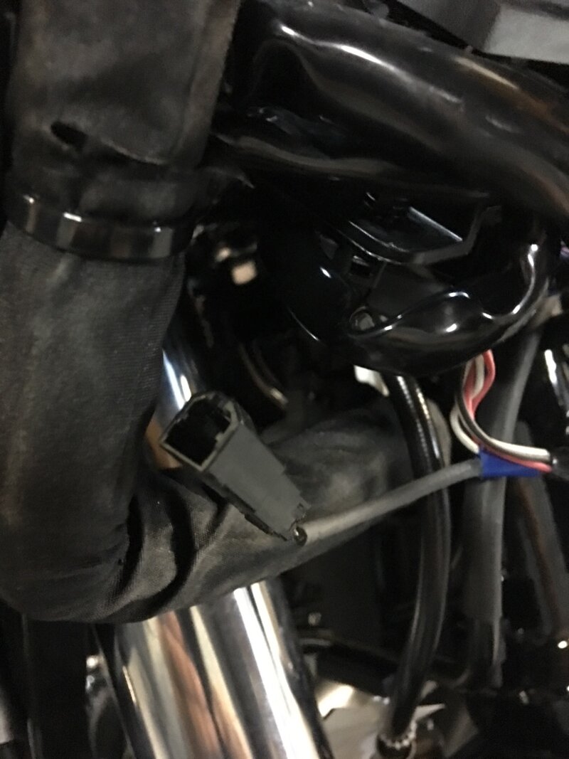

Now i caint seem to find where that small plug goes with the black and white wires i dont remember unplugging it but i read that its for heated hand grips does anyone know ????? thanks looks like ill be done tonight , man what a difference just sitting on it :pepper:
on mine, the right heated grip gets plugged into the center of the DBW . Two wire plug. Then the rubber cap covers it. I think it's what you ask :Shrug:
