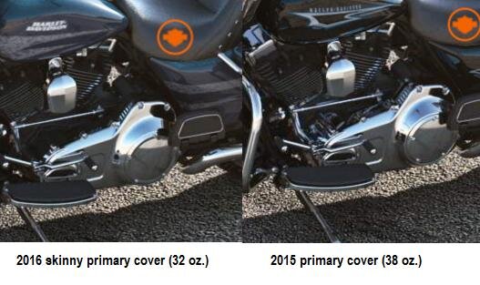

Harley is using 2 different primary covers .... and the skinny only take 32 ounces. MAKE SURE before you pour!
2014 - I use 3.3 quarts in motor, 38 oz in primary (not the skinny), and 28 oz in tranny (all wet fills).

What is the visual difference between the 2?
I was getting a knocking im the primary at times. Dealer said it was normal due to the new style compensator and clutch. I drained the primary and got 30 oz of fluid. I replaced the fluid with 36 oz. Havent had the knocking since.
