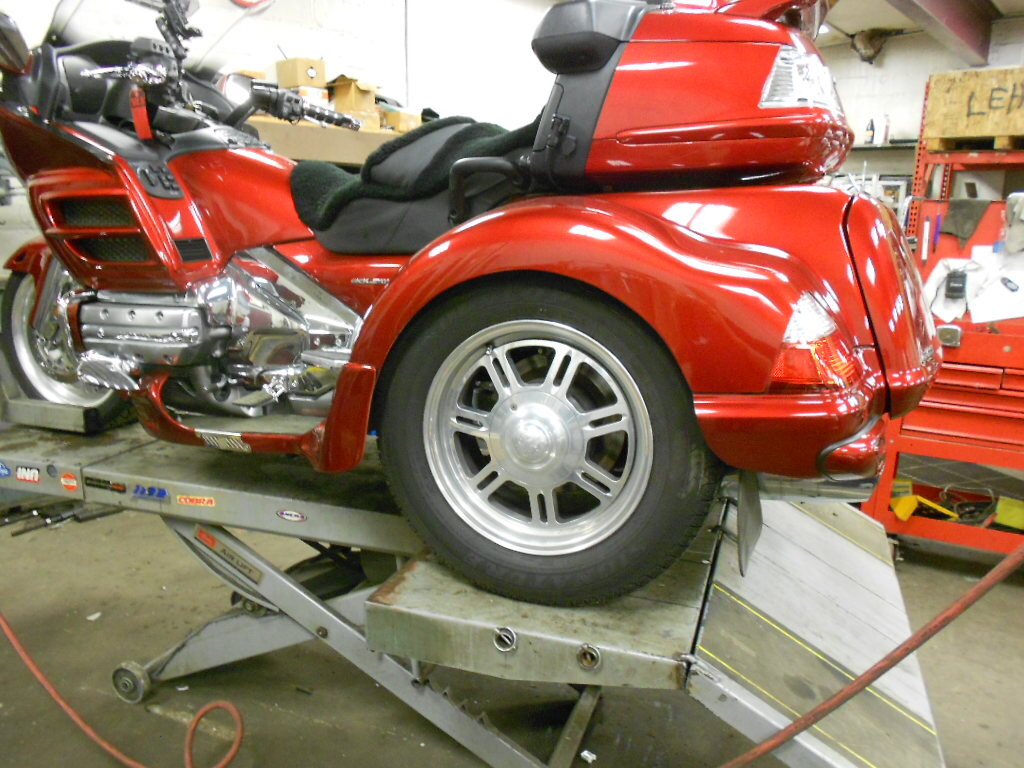

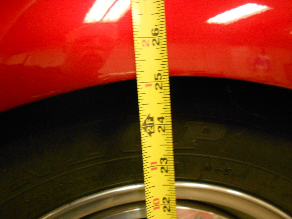

Measure from the ground to the top of the wheel-well opening.
You should have 24-25" on both sides. 25" is optimum.
In 2006, Lehman started including a heavier OEM monoshock spring in the kits.
You might have the standard OEM spring.
Secondly, there is also a heavy-duty auxiliary shock and spring that will also assist the OEM spring.
I wouldn't replace the auxiliary shock before checking the OEM spring first.

View attachment 73792View attachment 73793
Yes the picture in the avatar is the trike in question. I measured the wheel well opening and it is only 22.5 inches on the right side. It is just about 24 inches on the left side. So it is lop sided. What will it take to raise to the proper height? How much do the heavier OEM monoshock spring and the heavy-duty auxiliary shock and spring cost?

I'm wondering if you think this would fix my sagging suspension on our 2005 GL1800 Lehman MonarchII trike. Our wheel well measures 23 1/2" from the ground to the top of the wheel well where you measured one at 25" per your picture. A bit of background. We purchased our bike from a lady that parked it for 2 years in her back yard. It had only 15115 miles on it We bought it for a great price, $5000 and put another $1500 in it to get it back in shape. It rides down the road like a new one, but it is really low to the ground in the rear. Seems I would drag the mufflers over everything untill I put a trailer hitch on and now it drags. 2 up with a small trunk on the rear trailer hitch I can smell burning rubber if we hit a big bump in the road. If you think this would help, could you give me a link to where I could purchase the spring off your site. Thanks. Alan
