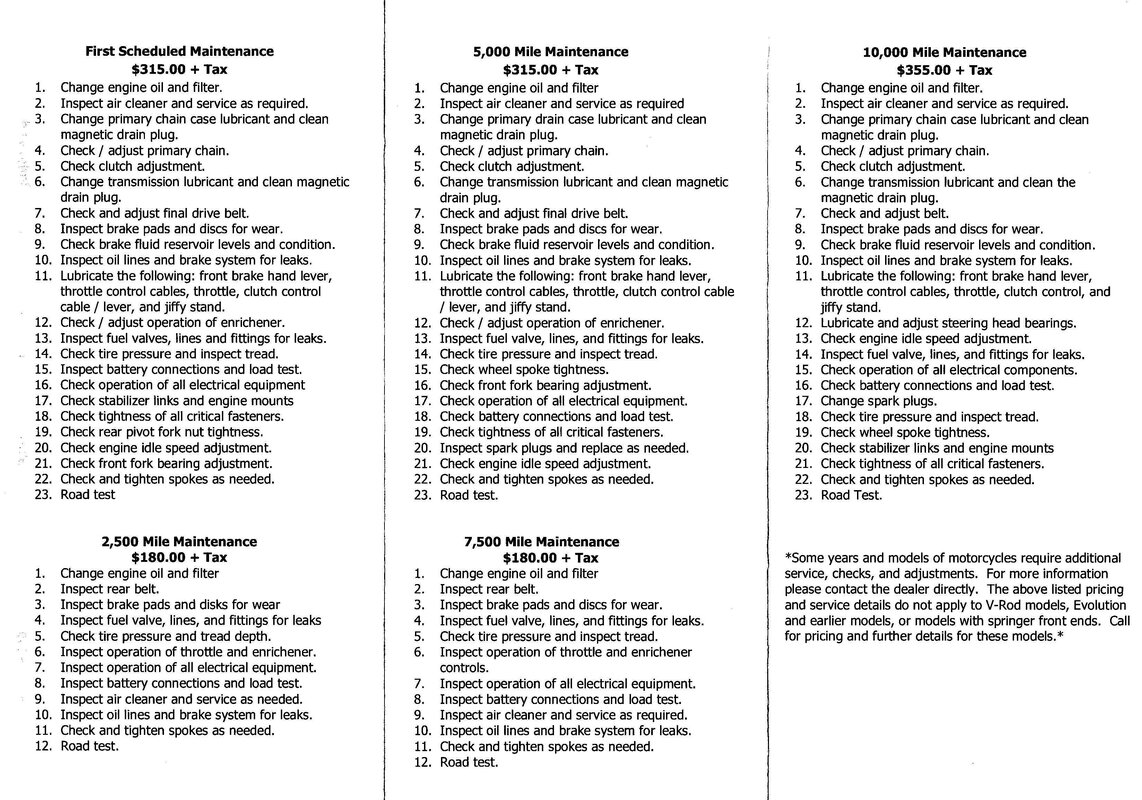

Here is my Dealer service guide.
Head bearings greased, front fork fluid change, brake fluids flushed?
Bob :D
