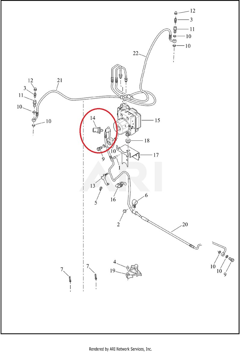

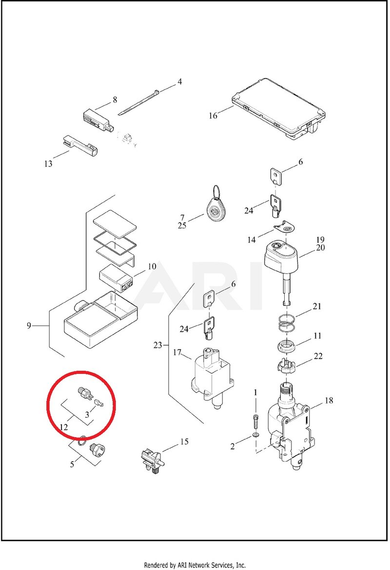

One other thing you brought a few posts ago, the switch they are replacing
This is the only switch I find that probably is the rear brake switch, other than the hand switch operated by the handle bar lever
Had the switch replacement done 2 yrs ago. The exhaust heat cooks them as it’s next to the cat on my 2012. No more cat no more issues.

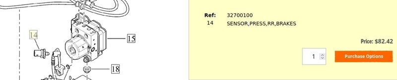

Just an FYI: The Switch/Pressure Sensor is not located where yours was. The 2019 & Later that have the TCS System have the Sensor located on the ABS Module under the R/H Side Cover.
My neighbors 2020 had a brake light issue this past July. We were in Maggie Valley and his brake lights stuck on and his cruise didn't work. After we got home he pulled the brake light switch that sits on top of his ABS module and as soon as he released it a big puff of air came out, so after about two minutes some fluid started to drip out. So he screwed it back in, and the lights and cruise have worked ever since with no codes:confused:. He did get his notice for recall also.
