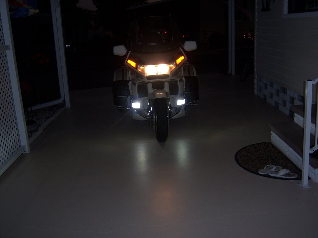

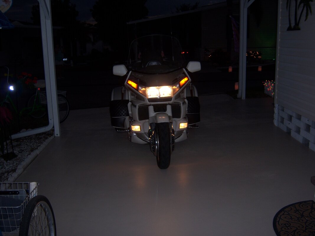

Thanks for posting the results Rodger. What is the actual difference in brightness from the rider perspective? I totally agree they are making you more visible but do they help you see better as you turn?
I'm with ZOOK.... Money well spent even with what you've shown us already. :xszpv: :xszpv:
They do light the side of the road a lot better, which is good when you have a broken spot in the shoulder or a dead possum laying in the road and hopefully I will be more visible.
