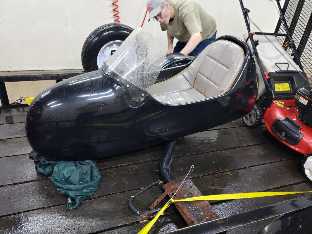

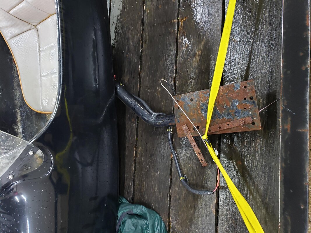

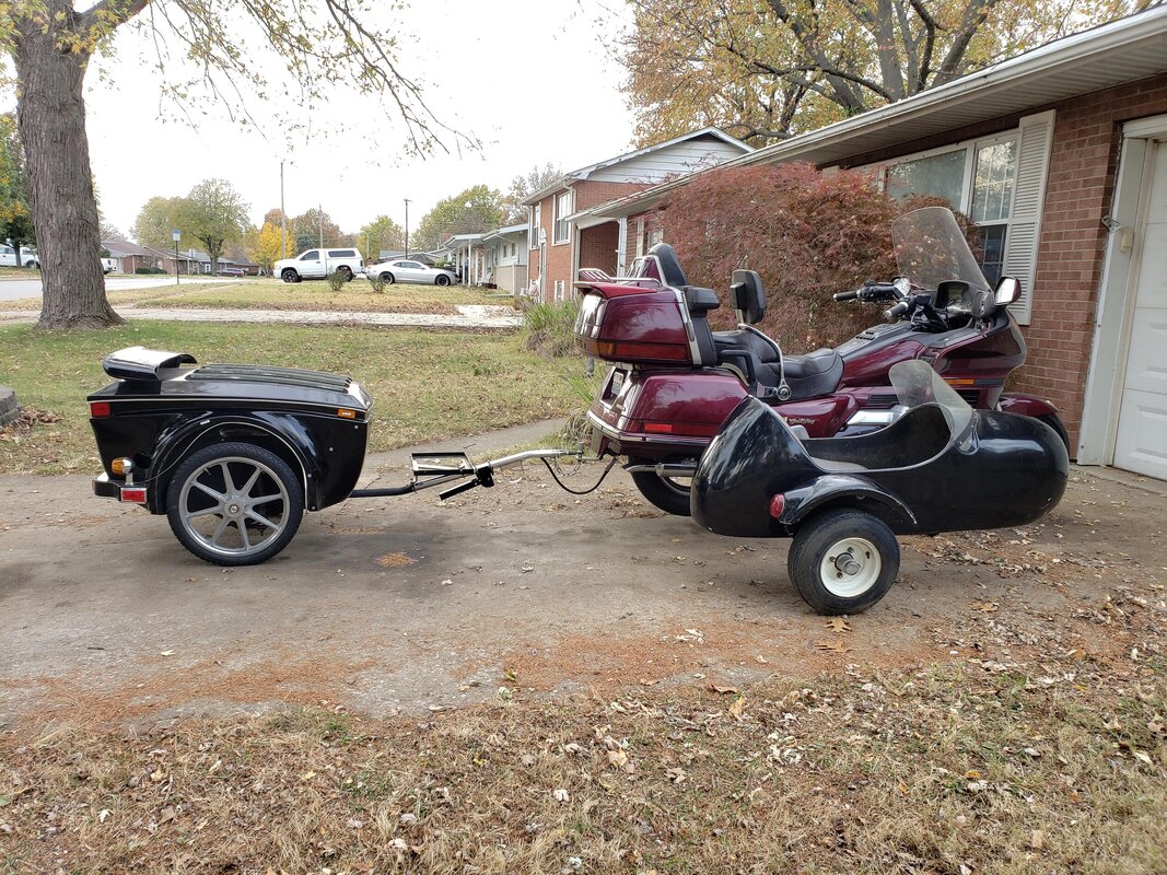

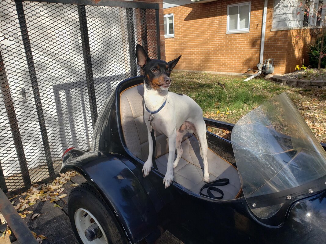

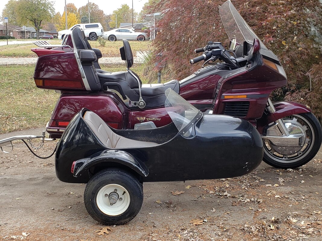

I just got this early 80's California Sidecar "Partner" model for free. Unfortunately it's made for a Vespa scooter. It has the scooter type mount. The frame is way to light to use with my wing. I only want to be able to put my dog in it. Even if it turns out just for rides around town.
I talked to sidecarmark and he believes there's just no way to make it work. He's probably right. But..... American ingenuity?....lol.
I've read that a sidecar needs to weigh 1/3 the weight of the bike. Is this a standard rule of thumb, or could it be lighter? It might be hard to get 1/3 weight with this small body?
I have a old Coleman Caboose trailer that I considered taking the body off of and putting this body on it. But then it would be a trailer. And might just be an eye soar. I all ready have a nice Bushtec trailer that I want to use WITH the sidecar. Plus I like the idea of the sidecar next to me to keep an eye Wilton my pup. Hey. I could call him "Sidecar Willy".

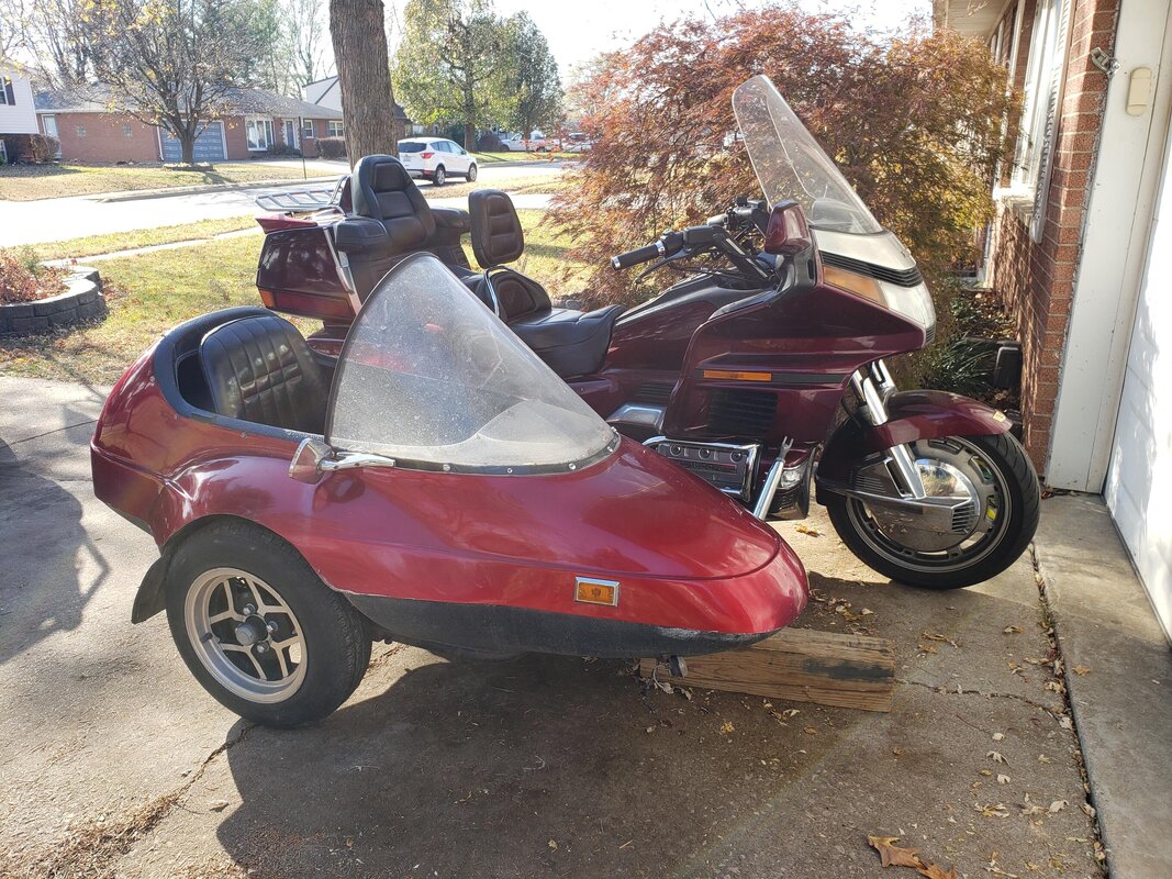

Then I've run across a used Tow-Pac Sidepack. It's a sidecar that is just a cargo box. It is made for the 1500 Goldwing. I'm wondering if I could use that? I'm waiting on pics to see what the frame looks like. Any of you guys ever run one of these?
I thought about placing an ad to try and trade this one for one made for my Goldwing. But that might be hard to come up with. I could just sell it. But I think I would come up short on cash. You guys got any clue's as to what this might be worth.
Thanks for any input.

You will find that car is tow light duty for a bike that big. Can it be done of course. That does not mean it is a wise move.
It is cool looking and mounted on a much smaller bike might be fun.

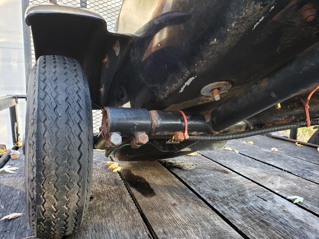

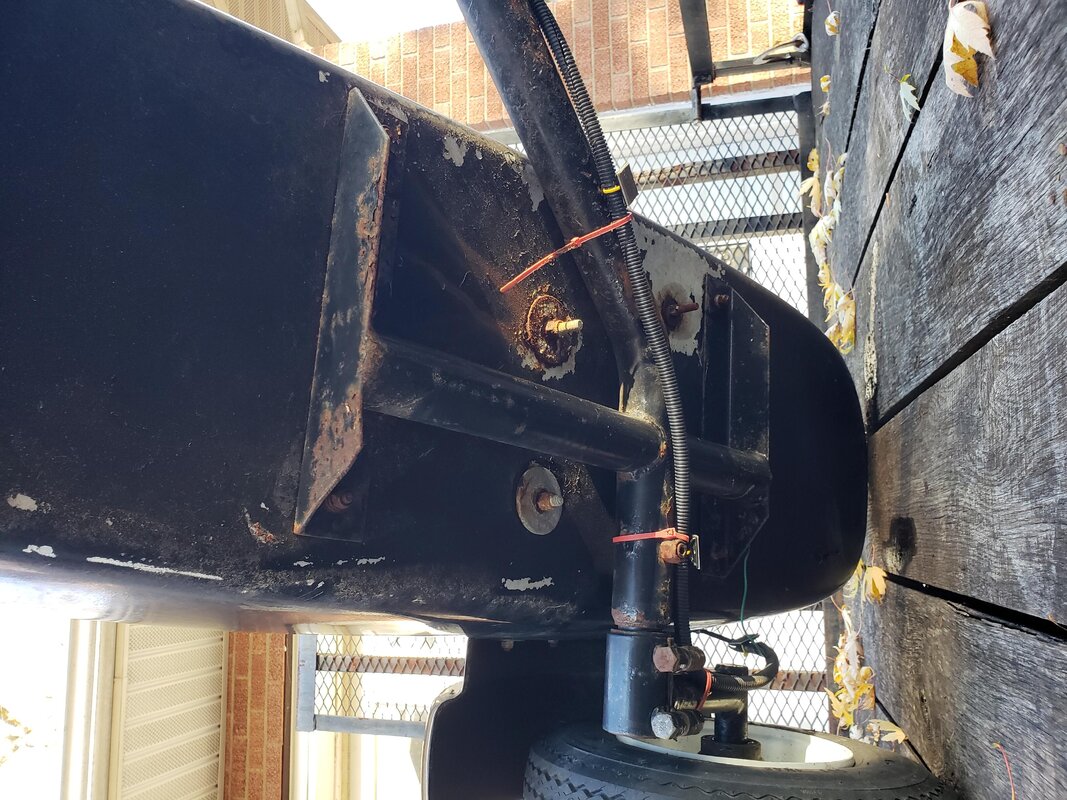

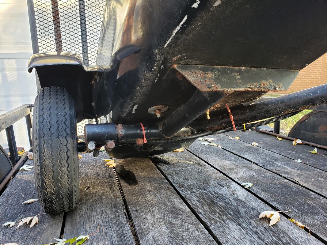

show some pic of the car frame.. determining factor...
1/3 is a general rule of thumb but that doesnt mean get a 50 lb car and add the difference
the tub doesnt matter much the frame is the issue
doesnt matter what or who u put in it...( i like some dog better than some people)..if the car is too light weight and fails u are still the one driving not to mention the public! certainly if something happened to your dog u wouldnt be happy

I was told that the body of the California sidecar models partner and commuter are basically the same. But the frame on the commuter is bigger for up to a 650cc bike. It also has a bigger tire and fender.
I thought I could just have a bigger frame made by someone who knows what they are doing, assuming I could find someone. But was told the body is just too light for this bike? It's just sad if I have to get rid of this one,,,lol.
Mine is a partner with a vespa mount.

I don't have the new one installed yet as I'm waiting on manuals, and a lean switch box. Do you happen to know how I can test the lean motor? It has 2 wire's. Are both hot and the motor grounds through the frame? Can I test it with just a battery?
Yup. The guy that bought it had the Vespa scooter it was meant to go on. He didn't blink an eye at my $1200 asking price.
ECC is simple they either work or don't. The switch is a basic two toggle . Don't go with with some cheap plastic one. Get one rated for 30 amps.
