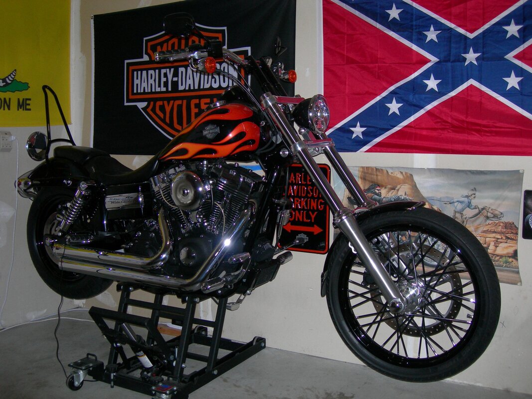

I've wanted to do this for a very long time.
The innocent victim awaits.

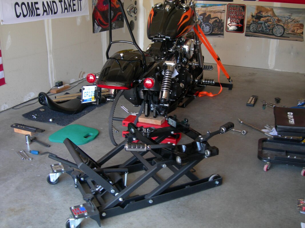

The rear wheel, the rear fork, and the rear caliper are history.

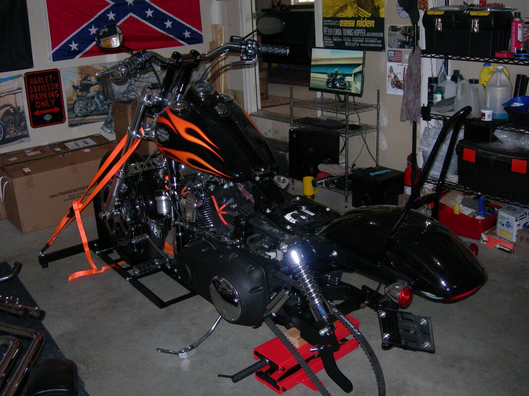

New rear fork installed.

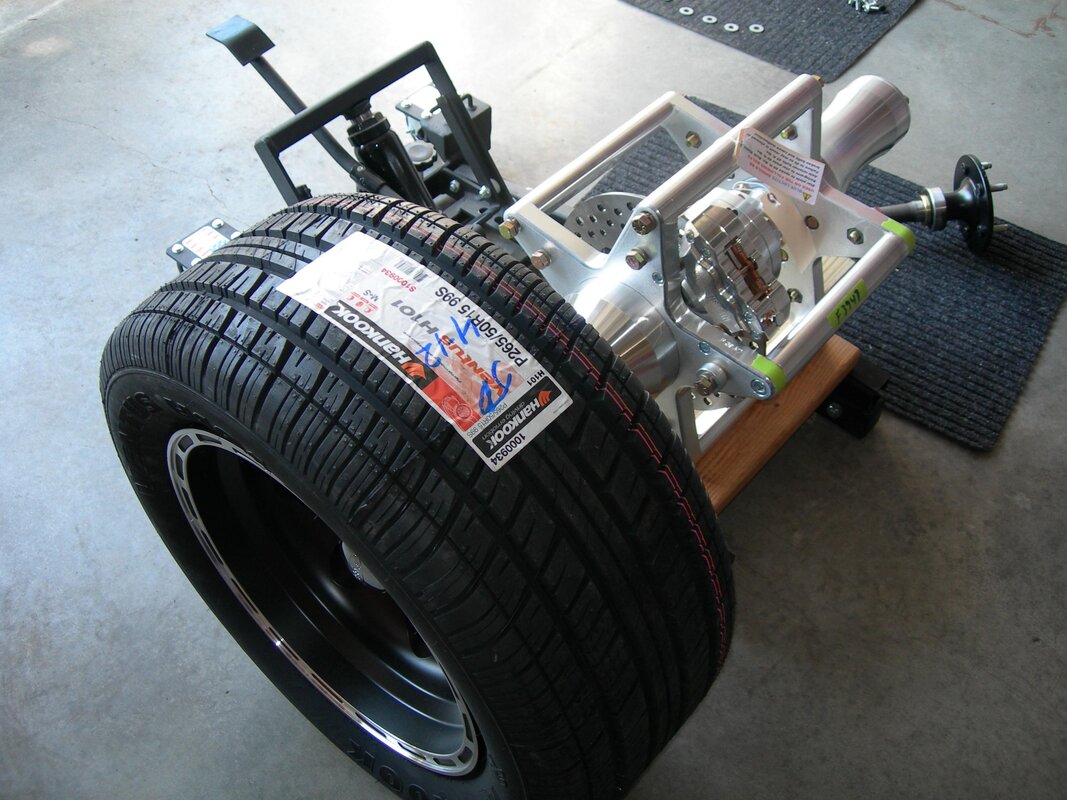

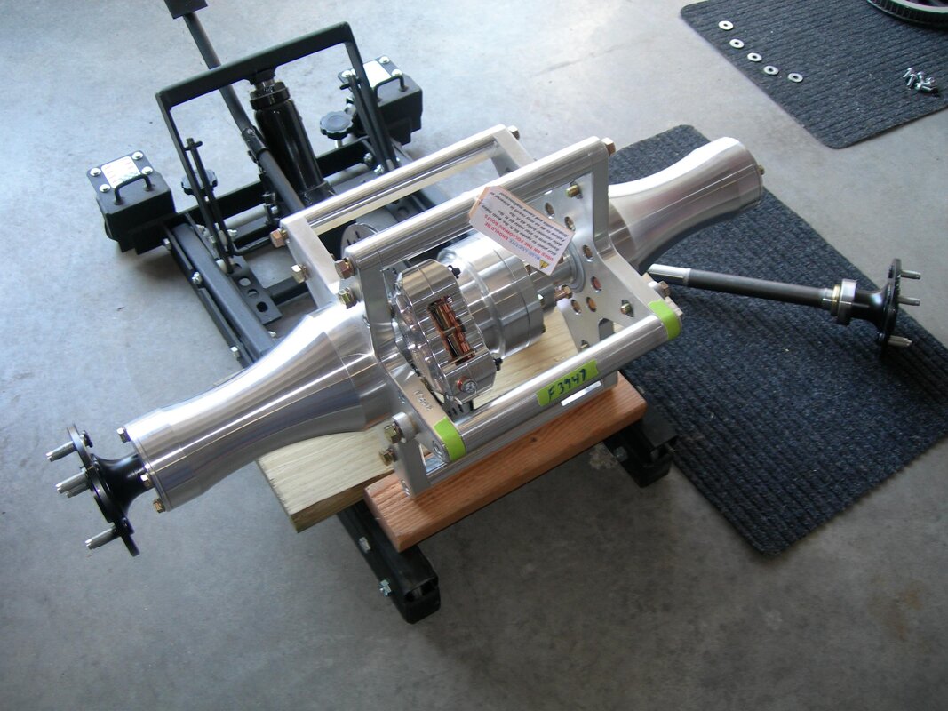

The Frankenstein 38" Sport Trike rear. This is some seriously, very well made goodness.
The 15" wheel with Hankook 265/50-15 tire installed on the right/brake side.

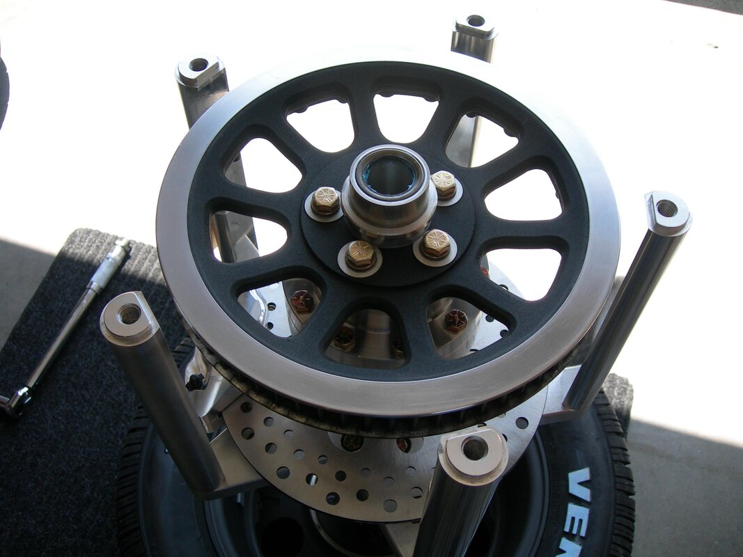

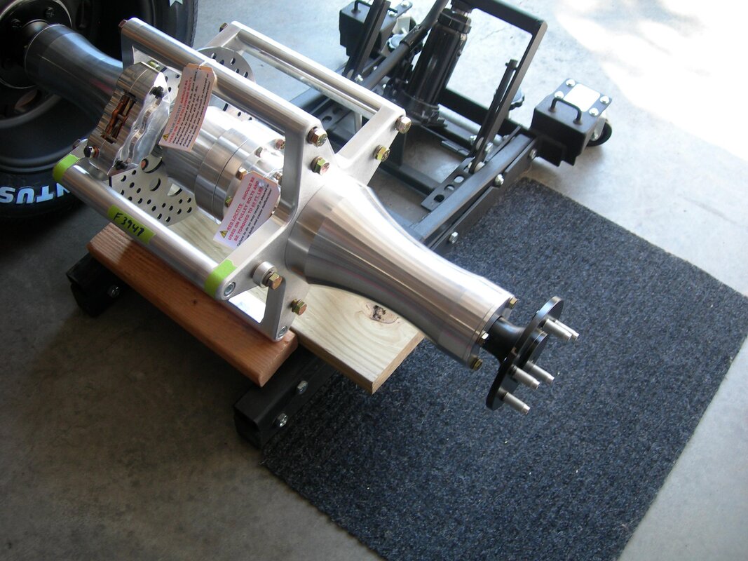

Drive line axle installed in the billet housing.
The drive line star plate and axle removed to install belt pulley.
Continued...
Ready to be positioned under the Wide Glide.
