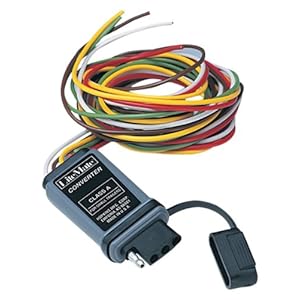

Apparently no one makes an adaptor/converter.
I ordered this part and will have to cut off the plug on the trike side.
It's a Hopkins 48915 60" Tail Light Converter.
