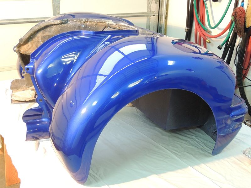

Body/Ground Effects Repair
None of the local autobody repair shops were eager to do fiberglass work, so took the body first to a boat repair shop to have the glass work done and then to a paint shop. The paint shop uses Dupont paint and is having a problem finding the formula for the 2005 Nova Blue. They may have to break down and order from U.S. Paint or ColorRite.<br />

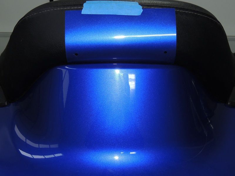

The owner of the paint shop called today to have me come down and OK the paint sample before he used it on the trike body.
A little history: The paint shops in Juneau use Dupont paint. Dupont does not have a formula for Honda's Nova Blue "PB356M".
The paint shop decided that they would do it the "Old Way". Needless to say, I was a little worried. Should be more trusting, I guess.
Looks like they nailed it!
What you are looking at is the paint sample taped to the back of the seat.
Yes they did ThumbUp

Actually feel lucky. When looking at buying the trike, I got an estimate for repairing the damage. It came in at just over $2000. The total bill, with me doing the repairs to the running boards, was $1684.
That's VERY reasonable for a full paint job like that. Looks fantastic!!!!....Am looking forward to photos after it's assembled and out in the sun!!!!!
