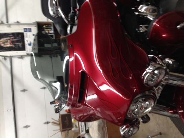

That really looks good,Rich. Your front fender looks like an aftermarket unit,now. ThumbUp
Just need some custom inserts on those brake calipers.
Yup the calipers need something and my fender extension needs something other than the plasti-dip I threw on there as a quick fix.

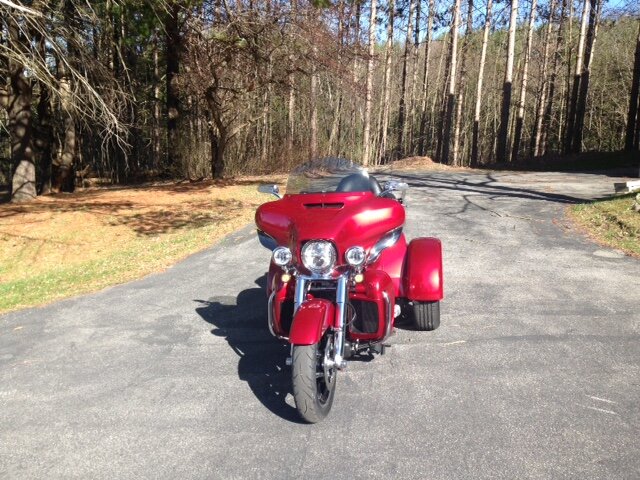

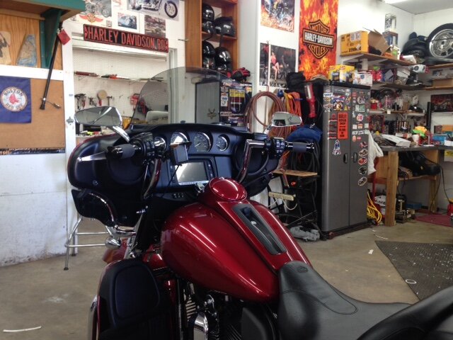

Last weekend I installed the DK filter relocation kit with Outlaw cleanable filter. Nice unit and outstanding customer service. Today I added Harley tribal mirrors and retractable cables for the trunk door. All that's left is lettering and pinstriping. here's a few pics that I took today. I passed a stress test Thursday and start cardiac rehab next week !

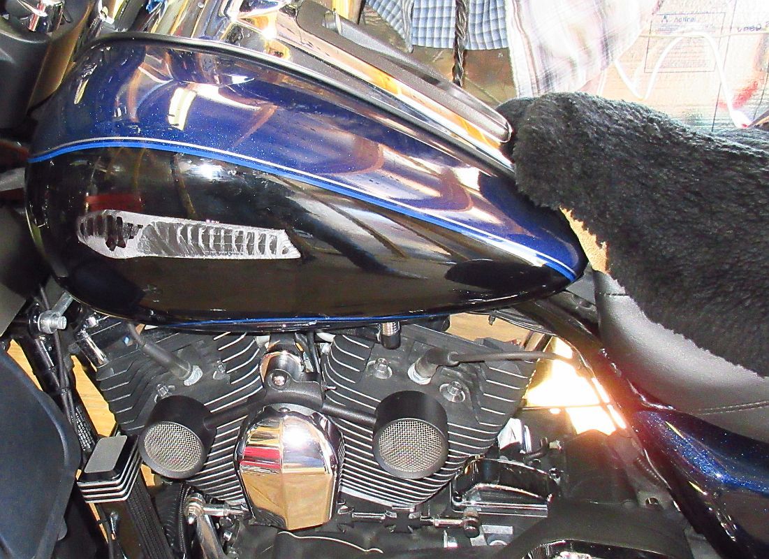

How did you remove the metal emblems from the Tri Glide tank? I find that my knees are constantly hitting them and I don't think I want them on anymore. Can they be removed like the rear fender reflectors with fishing line? Are they just put on with rubber back tape? Can they be removed without harming the paint on the tank? Thanks in advance for the input.

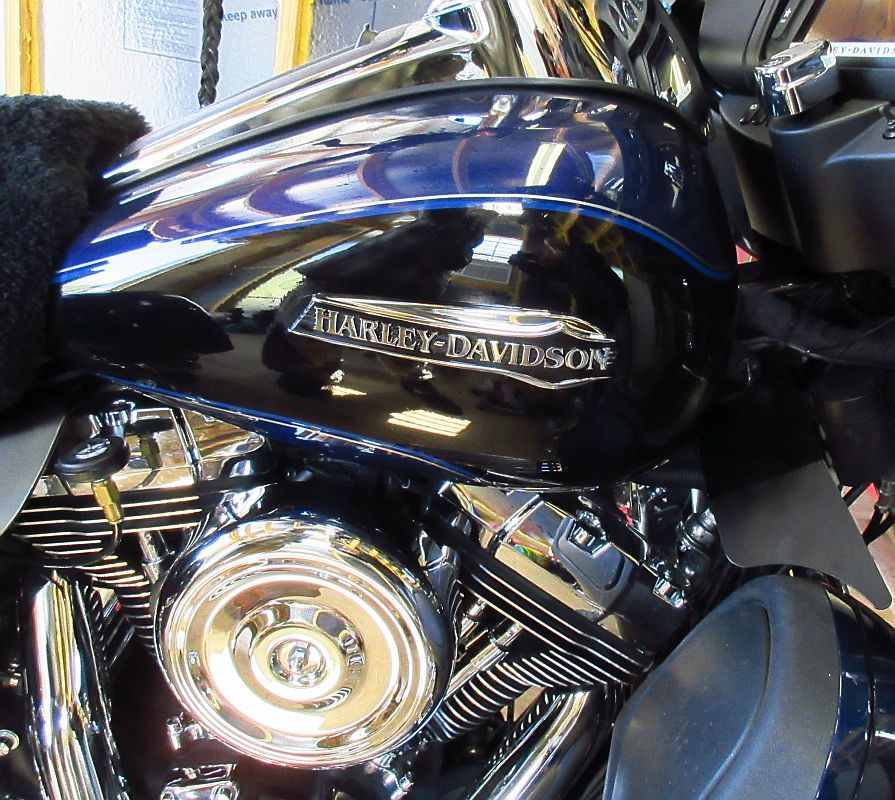

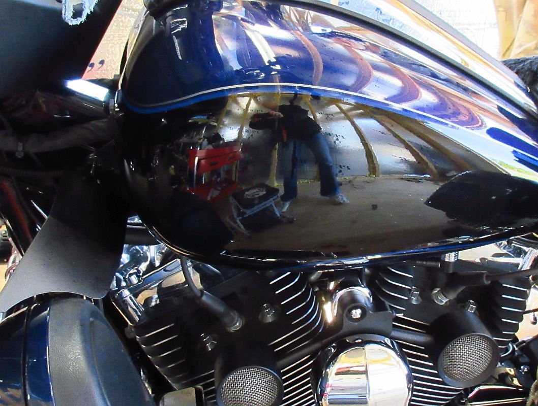

I used goo b gone and fishing line. Took 10 minutes or so per side...mine were metal with rubber back tape.
Here are a few pics of the transformation-
A liberal amount of goobegone, some gloves and fishing line
Kevin, The MOCO puts some heavy duty tape on the back of those tank emblems. I heated up the tank emblems with a hair dryer and then took fishing leader and removed the metal badges while protecting the rest of the trike. Then, the process which took almost an hour to remove the remaining rubber and glue with Goo Gone was quite a chore. I then used some high-end cleaner, applied that and then finished off the process with a high-end carnuba based wax. The tank now looks beautiful, clean and my knees will no long bump into those stupid badges. A case for sure for function following form.
Ack! That's a long time.
I put the goo gone on the top of the tape and let it sit for a few minutes before going after it with fishing line.
