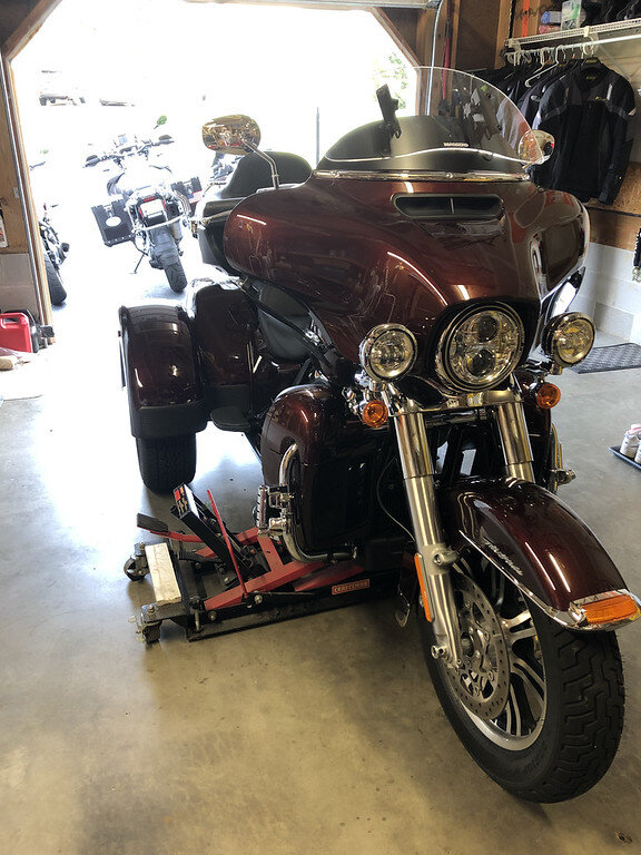

I have a 2022 Tri-Glide I installed a 12 inch Freedom Shields Touring windshield and the DK wings to lesson the buffeting
which both helped some but I still have a lot of head buffeting over 55 mph more with a helmet less without
With the 12 inch shield if I sit up straight I am looking over the windshield and if I slouch I look thru it
Is a taller windshield going to help much more ?
The money for another taller windshield isnt an issue I just dont want to spend the money if its not going to help.
Looking thru the windshield doesnt bother me so thats not a issue.

Sometimes it’s not the height of the windshield it’s the helmet… With my modular helmet at extreme highway speeds I get very little buffering with my three-quarter with a face shield I have some Buffering ‘ But with my half helmet anything over 50 is head shaking..

Bill-I experienced similar issues as you , and I use a Freedom Shield 10” and DK wings.
What really helped me a great deal was adding JES Fork Fangs.
Buffeting pretty much gone.
I summarized my findings in this thread; https://www.triketalk.com/forum/thr...-Jugs-Cool-Master-and-Harley-CoolFlow-Install
This was written after 1500 miles, I’m approaching 10k now.
I’ve had zero issues with added heat due to adding the fangs using both fan systems in my post. I also added a stage 2 kit as well, and my Tri Glide runs even cooler than stock.
I do agree also with the buffeting varies with helmet selection comments. No helmet, no issue. Full face modular, no issue. Half helmet (Harley) noticeable buffeting , I purchased a “ no mushroom head” low profile DOT helmet for states requiring helmets, noticeable reduction in buffeting.
I’m very happy with my mods and the ride I now enjoy.

I can almost guarantee you that the Fork Fangs and windshield like the Freedom Shield Recurve extra wide will do the trick.
It most certainly did for me and I had the exact same concerns. I’ve put on nearly 10k this year and 9k since I added the fans, Fork Fangs (windshield I added at 50 Miles) and I really don’t even think about buffeting any longer, because it’s non existent.
No helmet, nothing, modular full face Harley helmet, nothing, Beanie Helmet, nothing… the only helmet I still have issues with is my older Harley half helmet (mushroom top).
I look just over the top of my Freedom Shield 10” recurve.
Don’t give up the ship! You’ll find the right combination!
I went with a Freedom Shields 10.5" touring width, DK cooling wing deflectors and a DK 1.5" tank lift. That took all of the buffeting away for me no matter what helmet I wear. I regularly ride the interstate at 70+ mph to work with no issues.
Well I installed the JES wings/fork fangs last night. took it for a ride today little to no head buffeting

Just to repeat what I’ve mentioned previously… To counteract the potential added heat when adding the fork fangs I installed a set of Love Jugs fans, as well as the Harley CoolFlow fan.
My radiator fans runs less often after shut down with this setup in place.
I also added a Stage II with torque cam, which noticeably helped the motor run even cooler.
I see your running in a hot climate. I highly recommend adding some cooling help to counter the fork fangs engine airflow reduction.
(Adding DK’s cooling deflector wings would be your most cost effective improvement option IMO… I have those as well). Can’t over cool these motors! :laugh:
