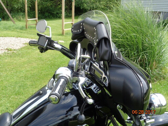

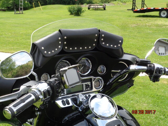

We use a Long Ride Shields: Flat Top Elite my bride doesn't like any thought of changing. good luck on your search. Fred by the way one shield is 9" is cold weather and the other is 6" Warm weather

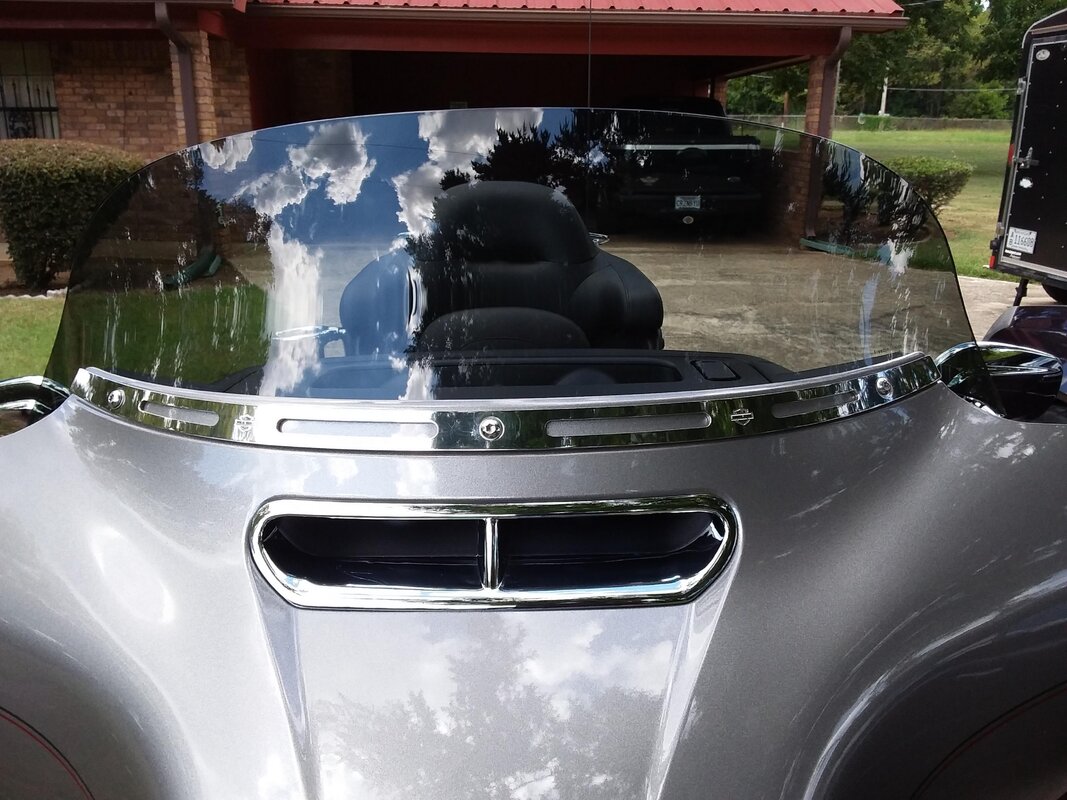

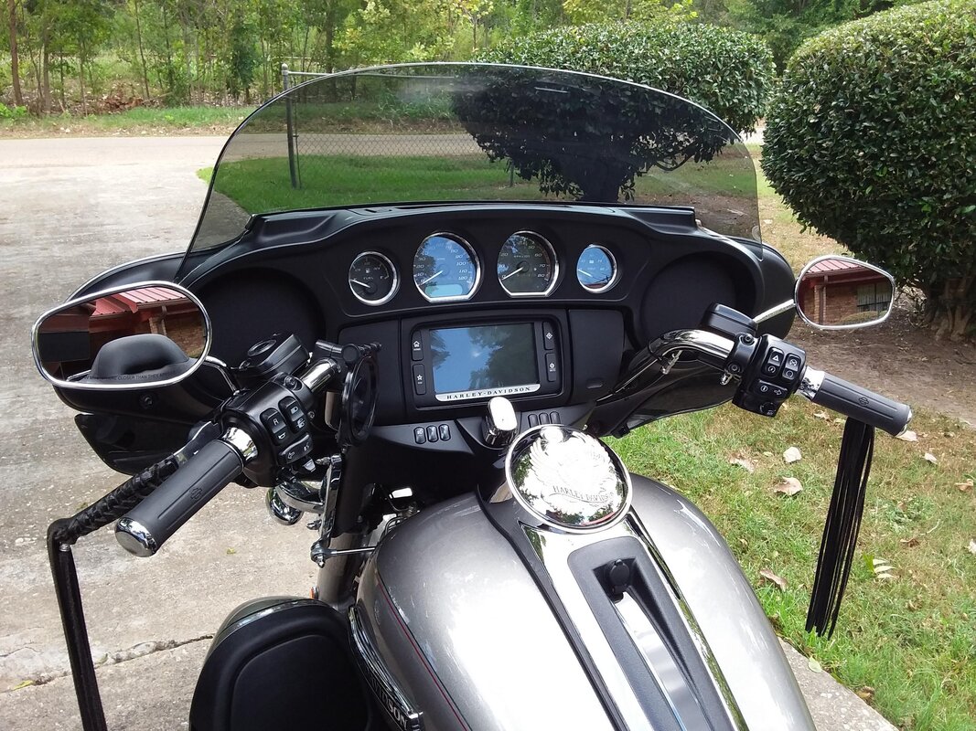

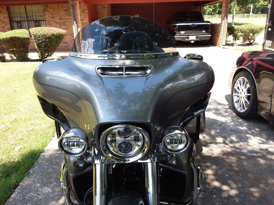

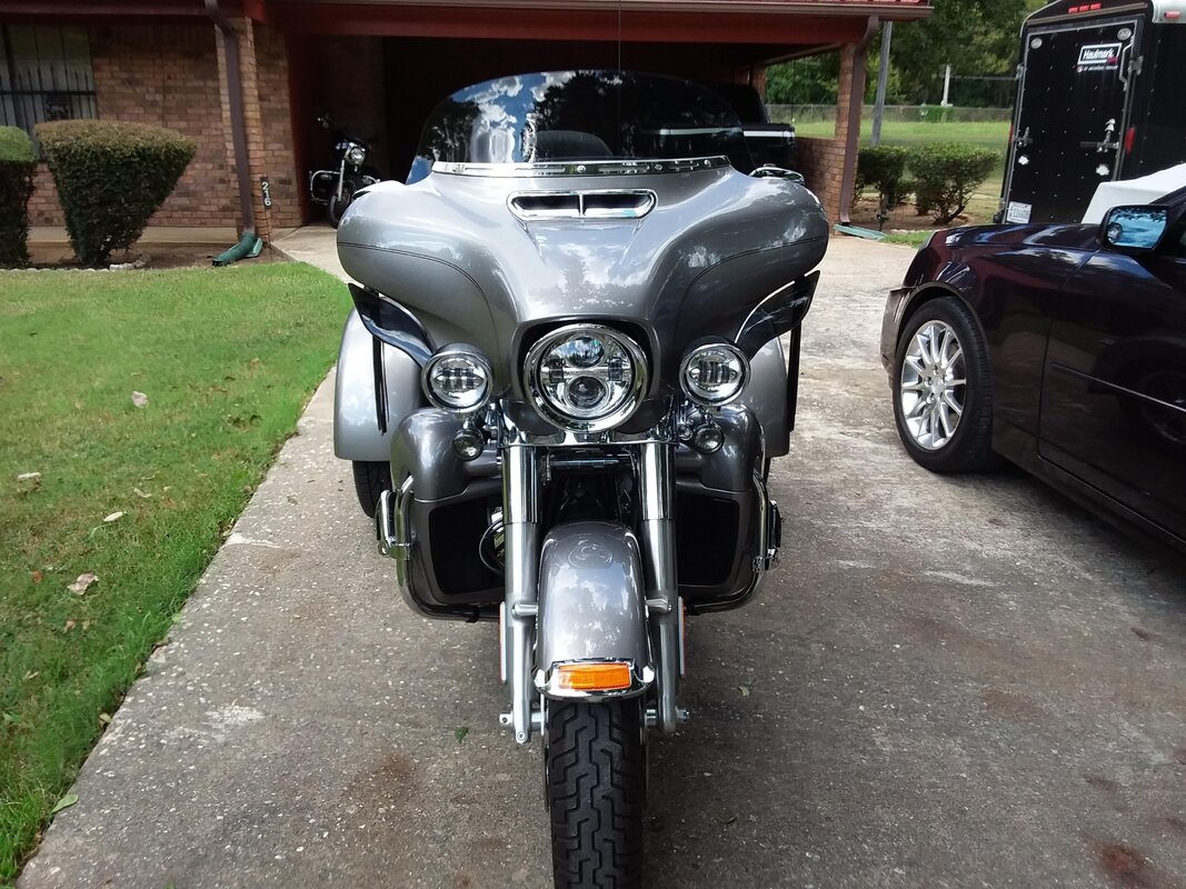

Freedom Shields 7 Inch Wide Touring Recurve
Was able to install and take a nice long test ride yesterday with the new Freedom Shields 7 Inch Wide Touring Shield. Halfway through the test ride all I wanted to do was hurry back and remove the protection film, because this shield wasn't going back. It has more recurve and a slight more forward rake than the 8 Inch Long Ride Shield, this accounts for their closeness in overall height. Where it gains an advantage is in those " Extended Width Wings" that extend out and downward toward both front speakers. That turbulent air that usually came rushing around the normal width shields, was now being pushed further out and away from the my arms, shoulders and upper body. They also seemed to lessened what I call the "suck and blow" air pressure effect I usually got on two lane roads when an 18 wheelers would zip by quickly in the oncoming lane . Steering inputs seemed much easier, I believe this was because the air pressure was now being moved equally outward towards the outer edges of the faring. This one's a definite keeper for me, but have yet to see if it performs as well in a downpour as the Long Ride Shields 8 Inch Ultra Recurve.
Bottom line: I like both....and I'm keeping both.
FS 7 Inch Wide Touring MGT Display.jpgFS Wide 7 Inch Touring MGT Close Up.jpgFront FS Wide Touring MGT.jpg
