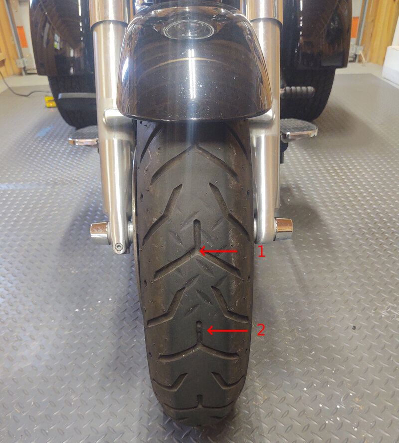

Where is the correct spot to check the front tire tread depth on the Freewheelers? At position 1, or 2 in the pic? I'm coming up with 4/32" in most places.
With a motorcycle tire in front of the Trike are we talking Harley Davidson Trikes now you will find that anywhere between 10,000 and 15,000 miles the center treads will look bald … While the side wall threads will look almost new.. because there is no leaning like on a two wheel motorcycle..(It will look like a over inflated tire) If you don’t mind heavier steering input run a few pounds less in the front tire and the tire will last much longer…
It looks like #2 is pointing to a wear bar. When you reach it you are down to 1/32”. I just replaced mine with 3/32”’ remaining, not because of wear but it was seven years old and had nearly 19k miles.
