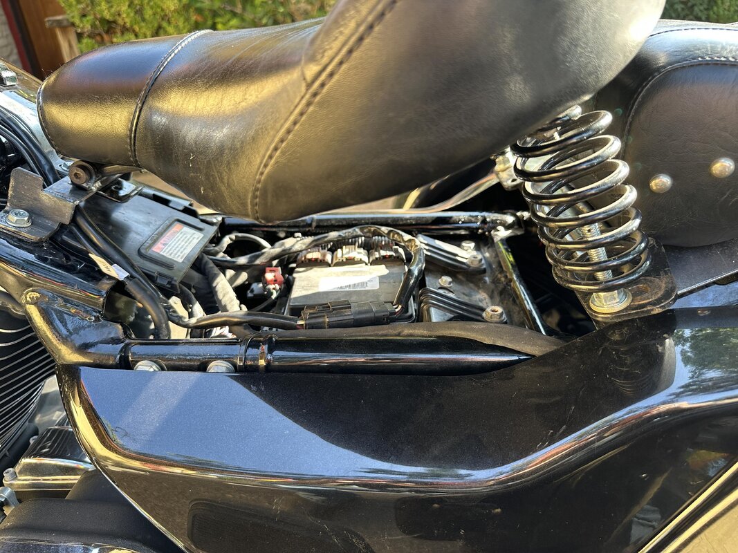

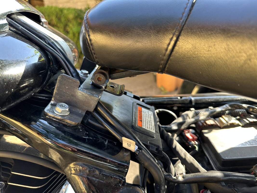

I had an OEM FXRP saddle on my FXRS, and after the FXRS was totaled by a hit-and-run driver I souvenired the FXRP saddle assembly. When I started shopping for trikes I knew I could find a way to make the FXRP saddle work on the FLRT frame. Last week I found a welder who was willing to give it a go, and.... SUCCESS!
However, the pillion seat I used on the FXRP is too long for the raised saddle. Since I won't be packing my wife anytime soon -- the hit-and-run crash ended her interest in motorcycling-- I want to do away with the pillion seat altogether and plate over that open hole. I see 'fender bibs' for Harleys of all sizes, but nothing for the trikes. Does anyone know of a ready-made piece that will fill that hole, or am I going to have to find a leather worker and pay through the nose for a custom piece?

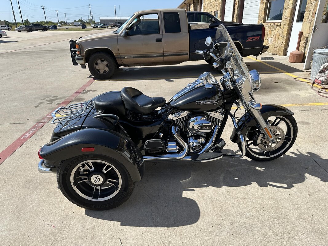

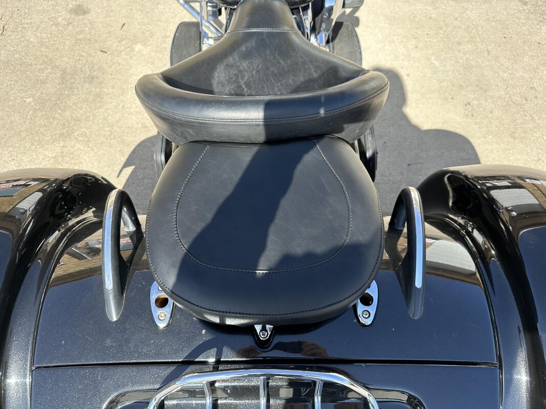

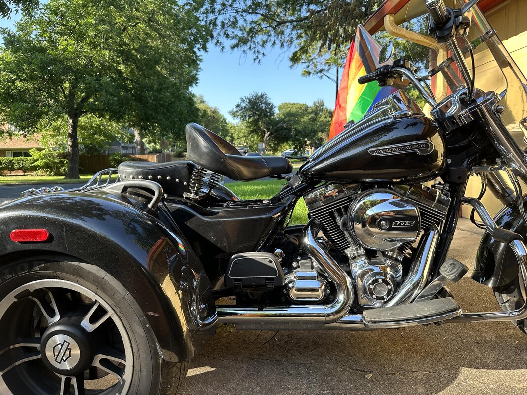

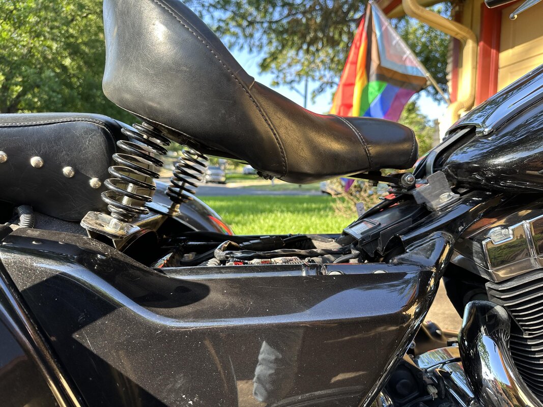

I promised a follow-up, and then fell off the face of the earth. Sorry 'bout that. Anyhoo....
For years, the shop where I worked sent upholstery projects to a fellow who called himself Bitchin' Bob. No finer recommendation, IMO, than to have Bud Reveile rely on your work. Bob later walked the Road to Damscus and changed his name to Steelhorse Bob. He now owns Texas Steelhorse Saddles in Liberty Hill, Texas, northwest of Austin, and that's where I went to solve my pillion pad problem.
I carried one of my Mustang pads and my OEM saddle out there, to see if one of those would work, but after some back-and-forth Bob went rummaging around in his pile of stock takeoff saddles, pulled one out and said, 'I'll use this one!'
As I watched, he stripped the cover off the saddle, cut it in half, and then proceeded to fit and cut, fit and cut, fit and cut until he had the shape he wanted. We agreed on a covering, and he said he'd have it ready in a week, and by gollum, he did! Looks like a factory fit, and very reasonably priced, IMO.
Bob does some mighty fancy saddlery in all sorts of colors, with all manner of design stitchery, and also works with the gel-pad cushions some long-distance riders swear by. He's a character, but he's a heck of a craftsman.
2016 FLRT Pillion Pad Project completed (1).jpg2016 FLRT Pillion Pad Project completed (2).jpg2016 FLRT Pillion Pad Project completed (3).jpg
That guy did a awesome job. It looks great. I bet it rides a lot better with that spring seat. How did it change your riding position?
It got my hips up above my knees, which was essential due to the nerve damage at the spine. I went with 3" springs, to give myself the best lift, but they turned out to be stiffer and stronger than I gave them credit for. The back of the seat is high enough that even with my full 185 pounds on it, the seat cants forward, and I'm constantly having to scooch back into proper position. I ordered 2" springs at the same time, and am considering switching to those.
As for ride: if you see my thread about shocks ( If this has been asked before.... (shocks?) (triketalk.com) ) you'll see that even with the spring saddle the OEM shocks are beating me up pretty badly. I'm ordering aftermarket shocks and a lift kit today.
I also had to adjust my handlebars a bit. Thought I might have to go to baby apes, because I was having to lean too far forward (which put my back in flexion despite the raised saddle height) but then I realized that someone -- previous owner, presumably -- had tilted the bars forward of the fork-tube line.
Pulling them back to where the manual says they should be made a huge difference.

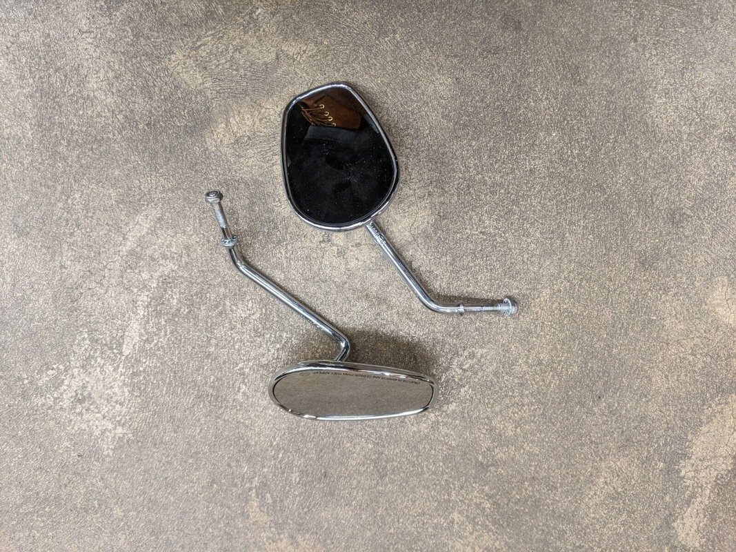

One problem I encountered with the rise in seating position is that it rendered the stock mirrors virtually useless. No matter how I adjust them, I'm looking at my shoulders and elbows rather than the traffic lane behind me. I've been hit from behind on my bikes, so I value rear-view capability. I'll be looking at long-stemmed mirrors today, to resolve that issue.
The growing pains with any 'new' motorcycle, right? :cool:
I scored a clean-looking set of OEM long-stem mirrors (Harley-Davidson part numbers 91846-03B and 91848-03B) on eBay.
They may not be perfect, but (as anyone who looks at either of my bikes could probably guess) I am much more concerned with function than form.
