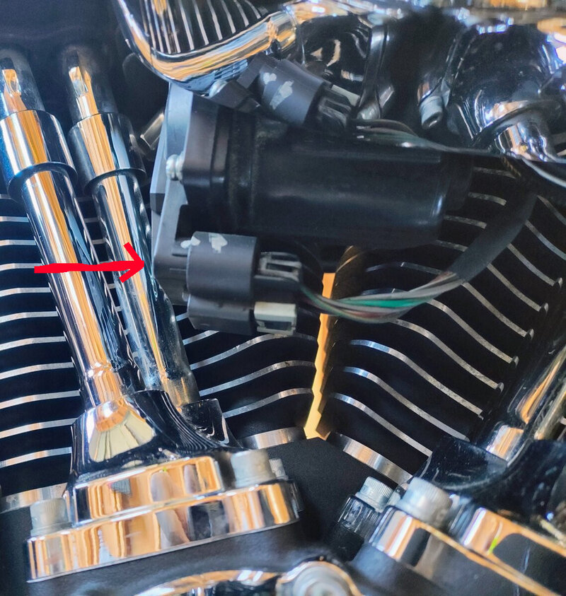

I have had 3 TPS Correlation Errors on my '21 Freewheeler since I bought it new in 2021. Parts books I have doesn't mention it, neither does the Service Manual. I'm thinking it's attached to the throttle body on the bottom with the 3/4" connector coming out the front of it. Is this it?

I think it is part of the throttle body kit

So I popped off the wiring and hit everything with contact cleaner then applied dielectric grease from Harley. Took it for a test ride with no issues. Ran great as usual and with no check engine light coming on. If they had put that plug on the other side of the TPS it would have had some protection from the elements, as it is right now it's right in the path of any foul weather you might encounter. At least maybe have the wiring harness cover the plug instead of having the wires exposed, but I'm not an engineer so what do I know.
