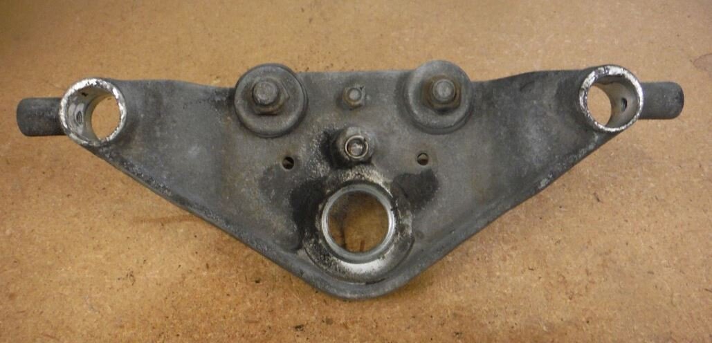

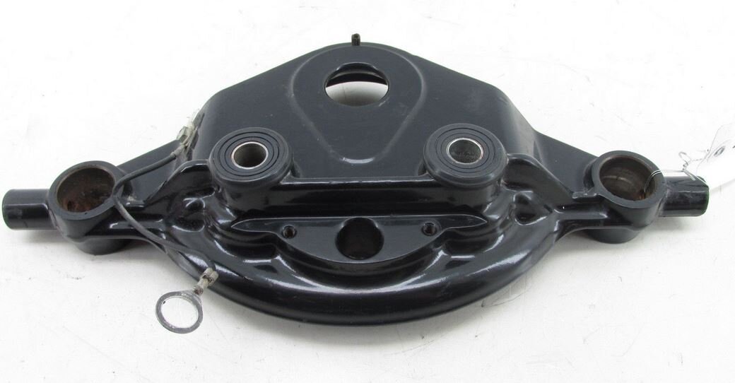

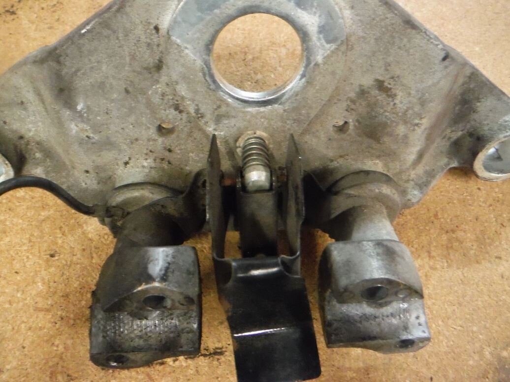

Several companies advertise their trees will fit 87-13, BUT they require some sort of modification to work on the older models (I think 92 & older? someone correct me if I'm wrong on that). The BIG difference that's going to cause problems for you is the steering lock assembly on your year model (uses a "toggle switch" style steering lock instead of the ignition lock). I may be mistaken, but I don't know of ANYONE who makes a triple tree that's a direct bolt on application (without modification) to your bike (the market just isn't there for a company to make an item with such low sales to be honest). I've attached a few screen grabs showing the difference in the FACTORY triple tree for your bike, & the more "current" design that most companies model their rake kits after.
Like I said, I know my response isn't going to win me any popularity votes, but I'd rather be up front & as honest as I can than sugar coat it.
