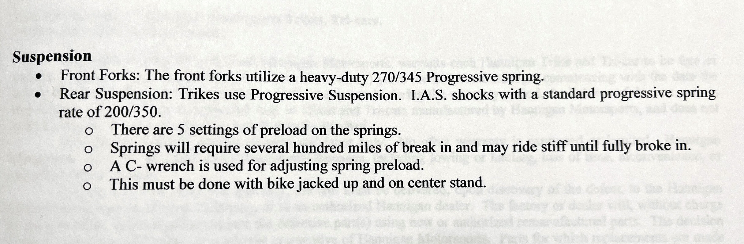

Found this information in my Hannigan Owners Manual which may lead you to the right road! Mine is a 2006 KLT converted in 2012 but should be the same..... Good luck!
