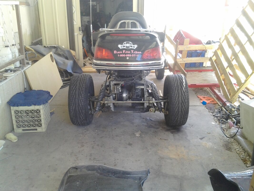

if its a dft you can change brakes easy they are factory Honda brakes.0621141109.jpg is this what you rear end looks like. does it use the factory rear drive.
Thanks everyone for all the input. triwinggirl you might have it, it does look like it. Now I need to investigate just which kit ( if they make different ones ) it is and if I can get maintenance book on it.
