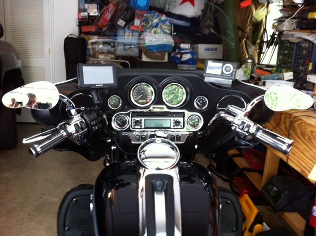

I have had the Road Tech Zumo 665 since we purchased the 13 TG. I have the XM Sirius subscription and have lost signal so much, I finally decided to relocate the receiver puck to the top of the tour pak. Had to purchase the extension cord from Garmin $18. I located the puck to the front left of the tour pak so the wire goes under passenger backrest. Now I have a very strong signal even in the garage. Never had that before. We have only carried luggage on the rack once, so figured if we do carry anything on the rack we may loose signal depending on the size. But over all much better reception now the puck is out of the bat cage.

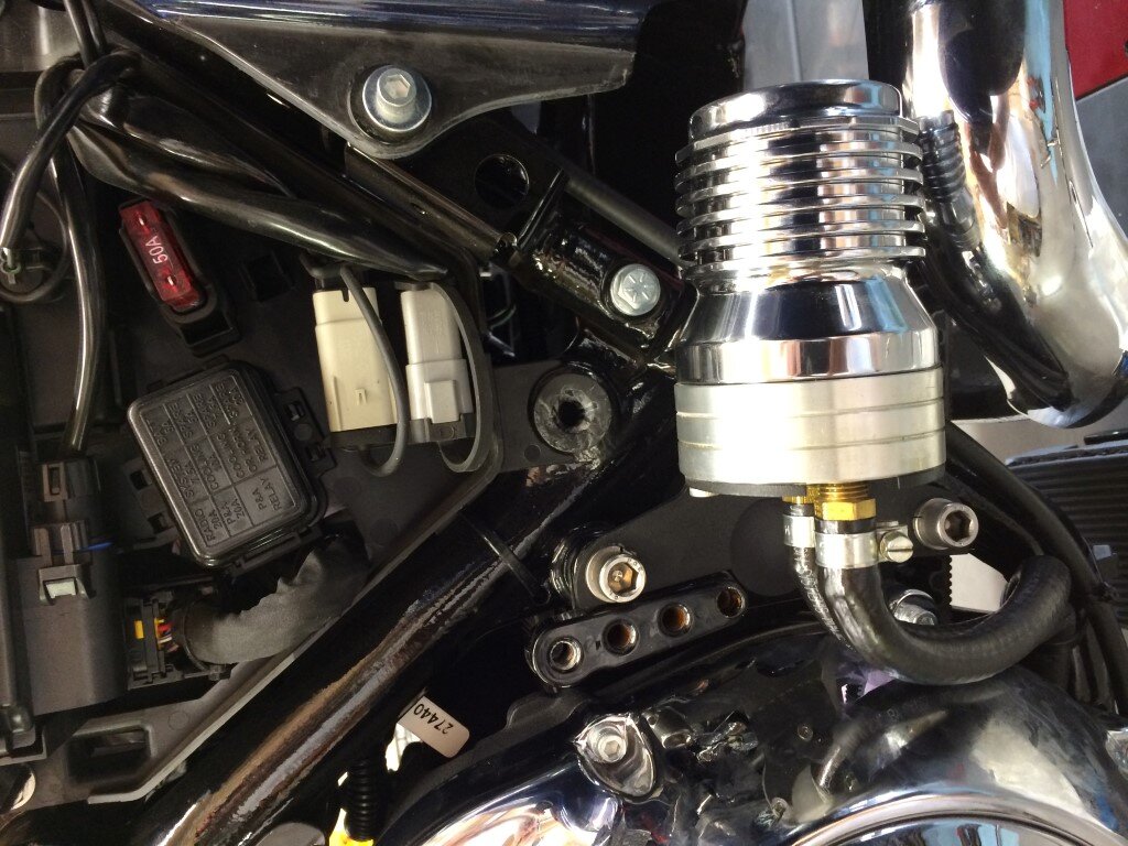

Installed Moore Sensible Products Remote Oil Filter Kit Part #RF6-09+ with K&P Engineering’s reusable oil filters with chrome housing. I'll post a picture tomorrow.
Very cool! We are playing around with different remote oil filter projects.
Good choice on the reusable oil, they make a difference, and if you ride a lot, they are more economical also.
ThumbUp
I like using the reusable filter for the main reason I can look inside the filter to hopefully see how clean the oil is.
This remote system works very well. Only concern I have is it rides very close to the side plate. I'll most likely put a small piece of clear 3M vinyl where it touches the panel. I might mention that my side panel on the left side does not fit as well as the right side panel and this is the main reason it touches. This winter I'll take it apart and have the pieces powder coated black. I also wish they had a mounting system that mounted to the down tubes near the shift linkage. This would get the filter away from the side panel.
If someone can tell me why these pictures are rotated wrong please PM. They are orientated correctly on my computer.
