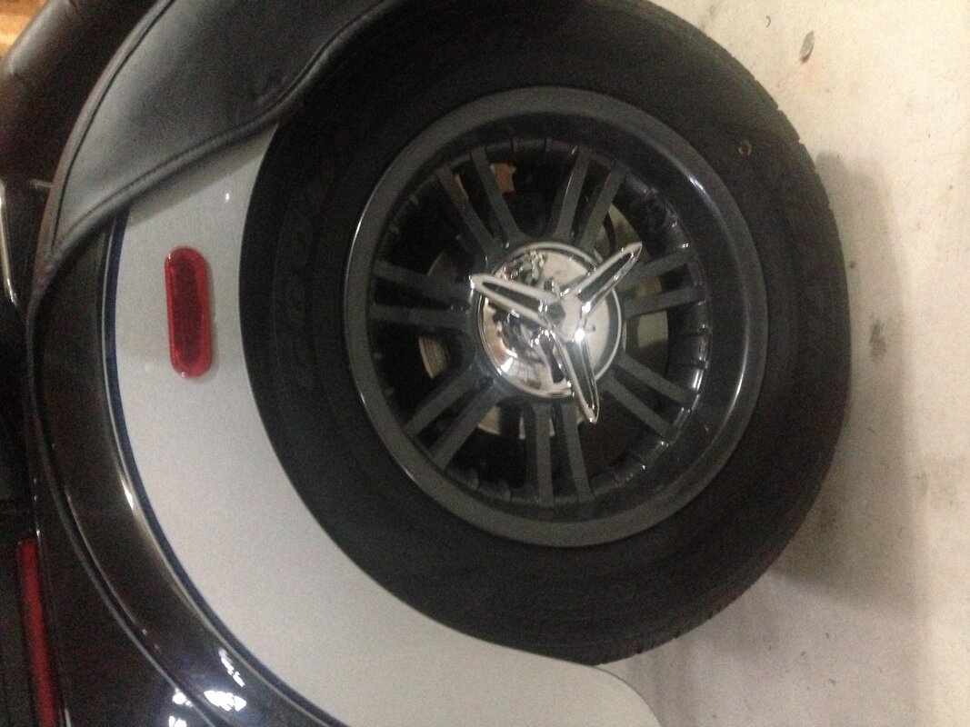

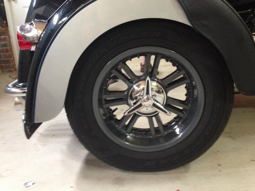

Installed my 1 1/2" tank lift and rear tank lift kit this weekend. Wish I'd gotten the 2" kit now that I got it finished, but really like the look. Think this is the first time I've been able to clean the rocker boxes on a stock bike.
8~\o
I like what you did with your rear wheels,Bill,especially the three spoke spinners. Where did you find those?
