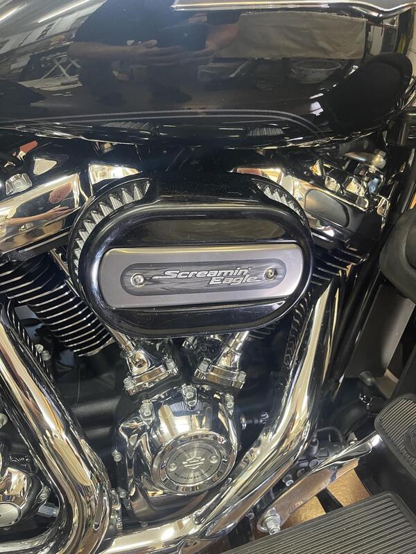

I've been wrenching on my 18 TG for the past 3 days and one more to finish up. Due to a bone head move that I don't wish to discuss, I had to remove the rear head. Those coolant lines atop the heads are a real PITA. While I was at it I replaced the lifters with Feuling ones. Dealer reused the stock lifters when they install the SE stage 2 cam 16K miles ago. Started hearing weird noises, so why not. Anyway, hope to be riding tomorrow afternoon.

A real rookie move on my part. Checking for TDC with a wooden chop stick. It did not all come back out.😳😵*💫 I knew better but did it anyway. A real brain fart. All good now though.😁
