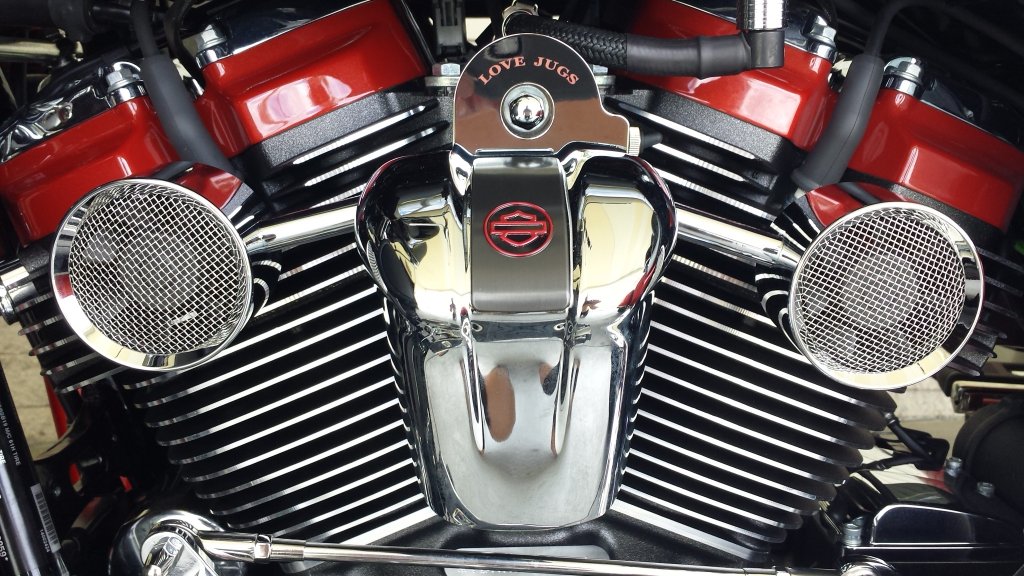

Today was a busy day for UPS and FedEx at my house. I replaced the stock AC cover with one from V&H for the VO2 Naked intake and filter. I cleaned my EBS. I installed a new antennae for my satellite radio on the tour pak. I got the new stubby cone style and I must say it works much better than the old standard block style. I installed the matching Kury ISO shift peg on my heel shifter. I had already put the long one on the front. I installed the Kury ISO large footpegs on my highway peg mounts. Installed the Kury grip end weights on the ISO grips with the throttle boss and got the boss adjusted correctly. Installed the Hogworkz stubby FM antennae in place of the long stock antennae to make using my day cover easier. I think that was all for today. Lol.

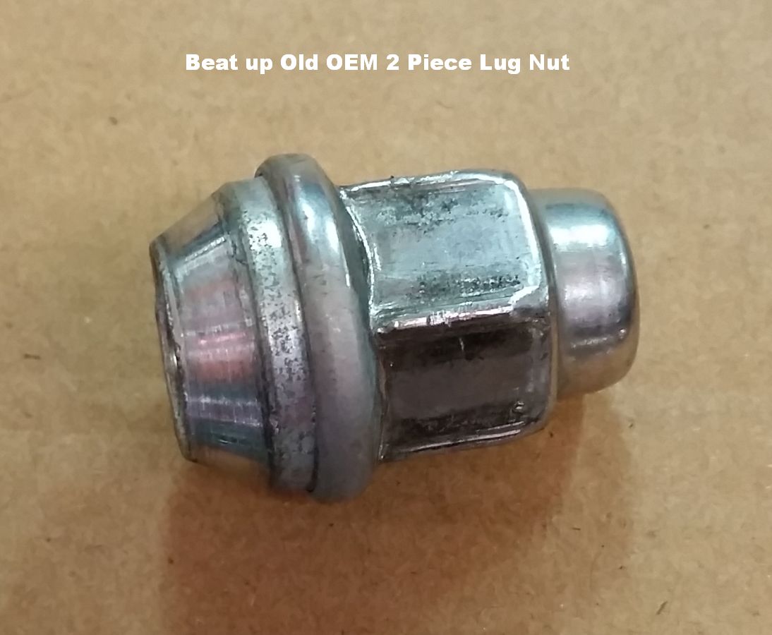

I ordered some new lug nuts. I have removed the rear wheels so many times for various tests, the lug nuts are literally worn out.
Here's a photo of one of the OEM 2 Piece Lug nuts.
They have an outer "chrome" colored shell. Over time, and because sometimes I used a 3/4" socket instead of the better fitting 19mm socket, that outer shell gets deformed.

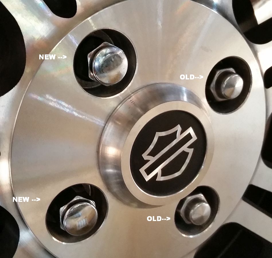

Here's a pic of 2 new vs. 2 of the old lug nuts.
All new and torqued down. Need to retorque them after riding 50 or so miles. (manual says 100 miles, but I generally don't wait that long)
Got more than I need...only have two wheels of 4 each.
Still have more little maintenance things to do before the ride out west in 13 days.

Kevin, what is the replacement nut ??? TIA
I wanted to get USA made, but after 10 minutes of searching, I am ashamed to say, because of my impatience at spending more time, it resulted in me purchasing some from MIKKUPPA
SPECIFICATION - 1/2-20 thread - closed end bulge style lug nuts - conical 60 degree seat - 19mm hex - 1.4 in. long - 0.87 in. wide
Triple chrome, cold forged and heat treated steel
I do like that they are one piece...and I doubt that the OEM are made in the USA...but still, if I had not been in a hurry I would have taken the time to find some made in the USA.
I have hated those phony cheap shielded cover nuts, I will take a true 1 piece nut all day long
I have over the years cut the shield off those shielded nuts and used an 18mm socket to remove them and throw them as far as I could
Water and ( in cold climates) the chemicals used to prevent road freeze would work under the shield and bulge it making a regular size socket useless, many of those caps were destroyed as a result, did I mention I hate them:p

Update to the post below-
I hit all the lug nuts with the torque wrench at about 60 miles after initially installing them. Only got one to turn a tiny bit before the click.
Today, another 250 miles later, out of the 8 lug nuts, 6 of them turned quite a bit...like 1/4 to 1/2 half turn before clicking.
VERY Surprising, and not confidence inspiring.
I can think of a few reasons this happened:
1. I did not have my torque wrench at the same ft. lbs. each time. I think I did, but I may have been a little off. I tripled checked the setting today, so I know where it is now.
2. Being new lug nuts they needed a bit more seating time than normal.
3. They are junk, (threads stretching or ???) and if so, they will be removed.
I will be riding another 150-200 miles this week and will be retorquing them again. If they have any movement before clicking, they are coming off. If they are still tight, then it was either #1 or #2 above.
Just wanted to let anyone who might be thinking of changing lug nuts based on my previous post to know that this is not a done deal yet.
