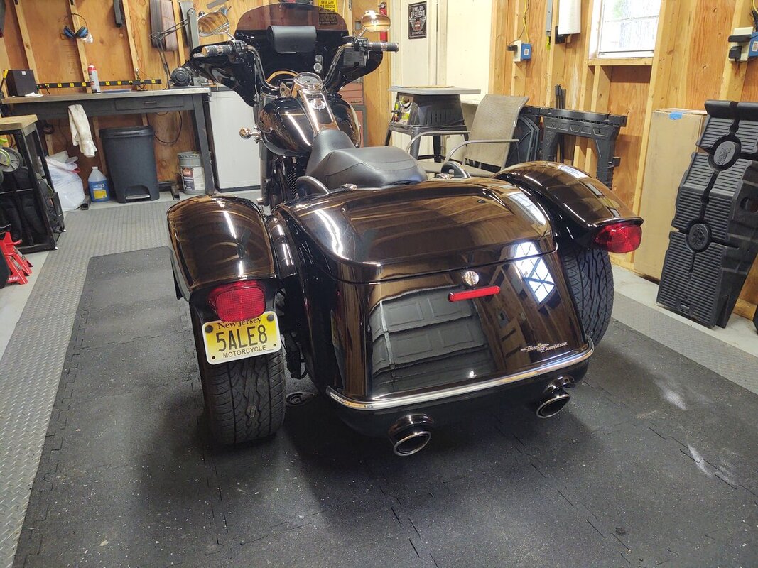

3.5 Mufflers
Got them put on - Those rear hanger bolts where tough - Anyway , took it out for a ride and I'm pleased with the deep rumble tone it now has - Not much louder ,just a better tone ,especially at low speeds - These aftermarket tubes have the louvered cores - No popping or high pitched sounds on deceleration either - Very happy with the upgrade
Which one were these?
