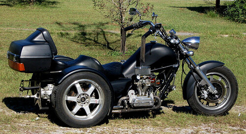

Mine is a swing axle and is the narrowest width to start with and then is cut down 6 inches a side. Total width to the outside of tires is 48 inch.
My wheel base is 66 inch.
I was specifically building for small size. It is much smaller than a converted wing and just a little larger than a std 2 wheeler.
What amount of ground clearance are you looking for?
Mine is 3.5 inch (unloaded/no riders/no trunk) off the ground.
Again I was specifically looking for chopper like stance.
It would be easiest to go with the vw stance but that means that it will be approximately 6 inches taller.
If you go with full width axle and cv joint set up you could squat the rear down enough to get low like I like.
Just think about what you want it to look like in the end and work from there.
I went through a lot of "unnecessary" modifications just for the sake of appearance. I modded the oiling and linkages in my tranny so I could run it upside down.
So anything is possible, just matters how bad you wanna do it.

So look at drag bug stuff for shorter axles. Look at mid engine dune buggy stuff for swing arms and shifter parts.
With the engine in front watch your amount of trail. Stay real low, long links on springer maybe.

A full size axle, rear engined, long enough not to wheelie, normal style, vw trike, handles fine.
If you build a mid engine comparable in size to a std rear engine and with proper steering geometry it may handle marginally better.
In my case I wanted something much smaller and more motorcycle like. Also I think it is better looking. Mine handles well enough but not ideal by any means. Most of my handling issues are due to HP vs size. Mine is severely hot rodded.
