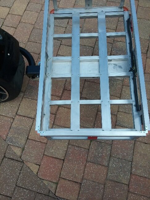

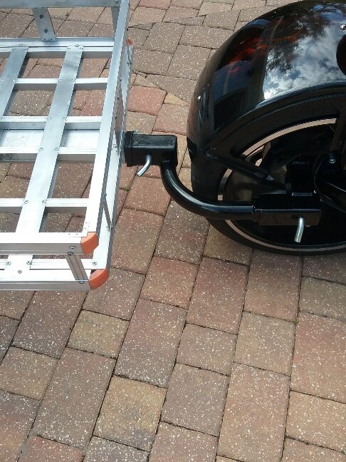

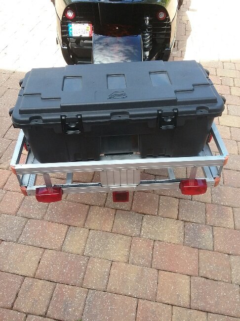

Trailer hitch and lugged rack mods
Shortened both ends of the rack by one section and my wheeled trunk fits great. Shortened the reciever tube about 1 1/2" and angle cut it to have more weld on the tube. I can still use the reciever for a ball mount if needed, just have to angle cut to fit the inner length of the tube. Rack from Harbor Freight and trunk (plastic) from Northern Tool. Tom

Hi Tom,
Nice looking set up for those short stays/trips where a cargo trailer isn't as necessary. I am curious how the receiver hitch is attached to the swing arm of your Carmel. It looks like there a hitch pin involved and if so, making it easy to disconnect I'm assuming, correct? Could you provide a close up picture of the attachment point when it's convenient?

Look closely at the photos as it isn't attached to the swingarm but bolts to the hub between the fender bracket and hub. All I did was change the end from a ball mount to a reciever tube so I could use the rack or slide in a ball hitch if ever needed. Tom

Thanks Paul but not sure about any trips for awhile. Already cancelled my Americade trip for June as all of the group I would have been meeting there have cancelled! That trunk actually holds more than the suit case used prior and that was good for a couple of weeks for 2 when you did laundry every 4-5 days. It's 37" w x14" h x 17" d. On sale now at Academy Sports for $25. Very light weight. Tom
