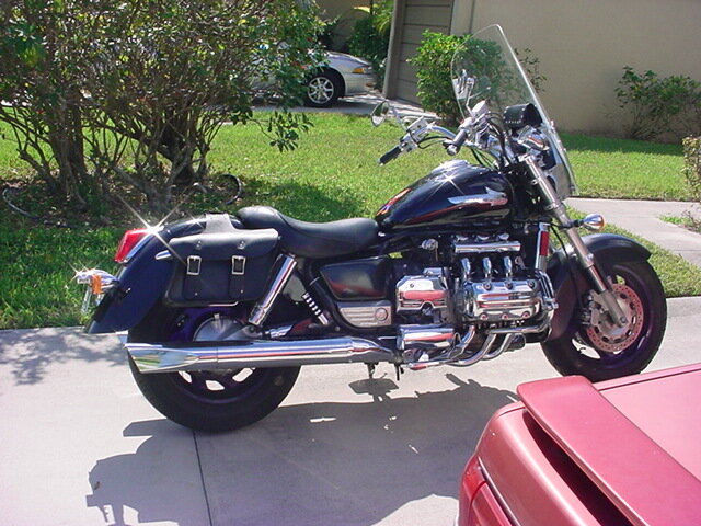

Originally I intended to use a Valk as my trike.
I bought a non running 1999 and spent 7 months rebuilding it.
I went through 3 sets of carbs alone rebuilding what I could, before I got 6 perfect.
I ended up selling it as I couldn't get anyone to make a reverse for me.
I ended up with a heck of a lot of used parts as new almost nothing is available,Unless you intend to use it as a weekend bike. Id give it some second thoughts. Overall maintenance is not of a an easy thing to do with a bike of this age.

The black is the end result. Most parts were NOS and I invested a lot of money for almost no return. If you look close the wheels are still purple.
Ended up selling it an oil rig worker in the North Sea from Norway.
Strange long trip it had been.
I rode it for a few months and really had no use for it after the fact.
Sold the bike the Camaro Z in the background of the 1st pic and bought my 2010.
